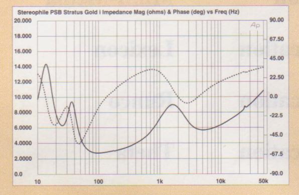

                        The PSB Stratus Gold i is a 4-ohm speaker that dips to 2.72 ohms at 97Hz. However, its not that simple. The impedance plot show a significant impedance rise in the midbass at the same time, presenting a severe phase angle and difficult load for the driving amplifier.
