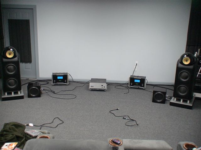

      I am fully convinced two subs are better than one. I agree it's important to be very conservative with the volume. A sub must extend the mains not sound like another speaker. Then when moved next to the mains as if they are part of the mains, the bass intagrated very well. The timing and spacial coherance is obvious to me in this position. One thing for sure, I'll never go back to one sub.
      Here's a pic of the final placement although before I got around to cleaning things up. I tend to make a bit of a mess when I'm auditioning and tweaking.

                                    I tried positioning my DD-15's beside the mains and wasn't happy. Moved them across from the mains (approx 6') and found the results much more improved. I am very limited with where I can place my subs. Both my mains and subs are on sound anchors, and I like the results. (2) SUBS ALL THE WAY :T

                                                                                    • Jesse111
                                                                                      • 335
                                                                                      Originally posted by Nicholas Mosher
                                                                                      Subbage Yet? I need pics and a review! :B
                                                                                      Dual Subbage has arrived.
                                                                                      Arrived yesterday. Plugged them in and letting them get to know their new friends - Bowers, Wilkins and Mac. Already took a few pics. I'll start a fresh thread Entitled "Dual DD 10's" in the next few hours with the pics.
