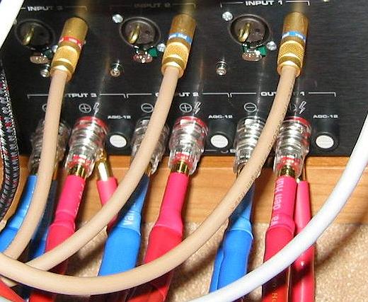

                    I need to expand a little on my previous post. First, a confession: I don't run 2X2 cables. No, indeed. I'm even crazier that that. I run 4X1. That's right, on all my biwires there is a physically independent + cable and - cable which comprise a pair for the speaker terminal pair. Thus, my 805S's and HTM4S each have four cables going to them. The three front speaker cables total 12 cables!!!! I indicated 2X2 above because of the choices you gave and I didn't feel like trying to justify my weird configuration. Note, however, the reasons given for 2X2 configuration remain the same for my 4X1's. I didn't completely lie. :W
                    The reasons for this are based upon the fact that the speaker cables are my own design. To achieve my design goals (minimum capacitance, minimum coupling, minimum surface effects, many small ga. high purity solid copper conductors) it was more practical to separate the cables. Because the cables utilize many small insulated conductors arranged in a flat shroud, it was easier to use independent runs. It is not as terrible as it seems. The cables are fairly tidy and only about one inch wide. They run under carpets very well. Only at the amp does a traffic jam occur. It's not too bad.
                    BTW, these cables sound great, IMHO. I've compared them to a wide variety of good cables in different price ranges in a variety of high end systems and they have not been bested. Are they the best? Noooooooo, I don't think so. I wish I could say they are but my testing sample is way too small for that conclusion to be reached. That would be dumb. I also know that cables are quite system dependent. I don't think there is a "magic bullet" cable out there that will be best in all systems.
                    These cables were designed, evaluated and tested for my main system which drives my Martin Logan electrostatic speakers with an ARC tube amp. I hoped they would also do well in my bedroom with my Krell amps and the B&W speakers. They seem fine but I have not done much comparison listening on this system. It's very possible they could be improved upon. The Krell/B&W system is electronically very different from my main system. At least they are not grainy and have a very smooth but not rolled off top end. Good detail. I'm satisfied.
                    They have a huge advantage over commercial cables. I can build them myself, in any desired length and configuration and the price is definitely right. I don't charge myself for my time which is significant.
                    I also designed and built my own interconnects. Since I did not have to worry about high current, I evolved a totally different design which is much harder to build. But they sound good. I run single ended all the way in my systems.
