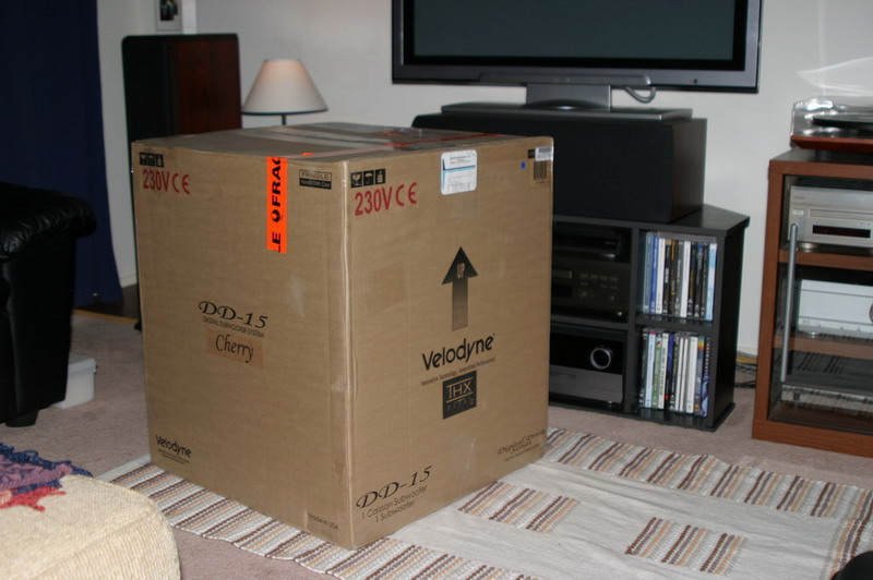

    I shouldn't have watched that velodyne video ! Ended up getting the DD15
    • bleeding ears
      • 435
      You are kidding, that box is big enough to fit a washing machine inside.
      Is that the monster with a lamp sitting on top? Wow, I bet the neighbours love it ! :lol:

        hehehe photography can be quite deceiving, its a lot smaller than it appears. Quite a lounge room friendly thing I must say. Wife likes the look of it says it can stay !

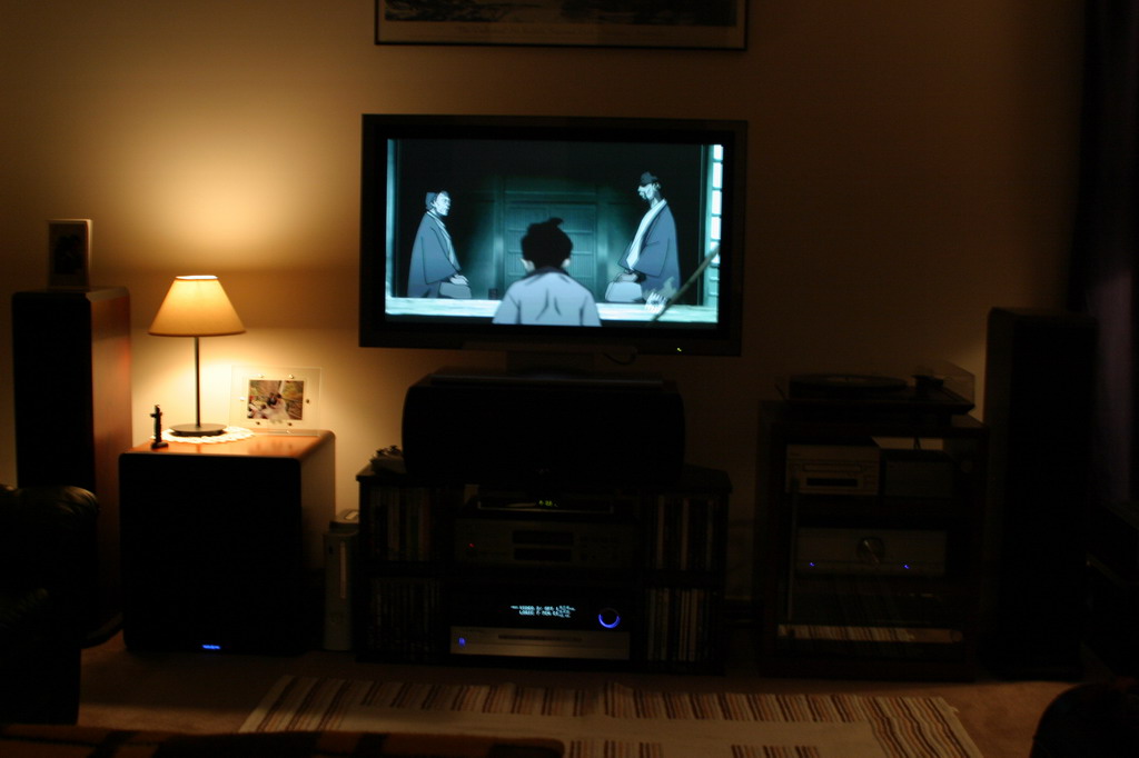

        Having a ball playing around with the eq side of things that comes with the DD. Gettign reponse plots of the sub in my room, my mains, and the combined response. Pretty neat too the auto eq it does - gives a pretty reasonable result with bass down to 15hz in my room. Haven't really gone into any tweaking as yet, plenty to still muck around with.
        Watched harry potter and the goblet of fire tonight. Boy ch25 is a beauty when he meets up with waldermort plenty of low bass energy there !

          And I must say it looks and sounds great at your place alebonau
          A very attractive unit (not that big) and punches well above its size
          I love the sms1 tweaks on the screen too
          PS your cat looks happier than mine, but mine is trying hard :lol:
