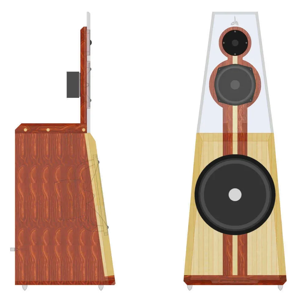

                                                                      I made some small changes to the design and have started cutting mdf. I have cut the raw pieces for the mdf bass bins, but have to cut some rabit joints and all of the slots for the ribbed box construction. I will try to take lots of photo's to document the construction as I go along. For initial testing, I'm making the bass bin baffle and the open baffle section out of mdf. This is because I want to test the concept of rear mounting all the drivers, inset 1/2" with a 1/2" roundover.
                                                                      For the tweeter, this will function as a shallow 1/2" waveguide. I followed Zaph's concept for this, proposed for an easy way to mount the Vifa D2NC55, on my Duo project and it worked exactly as he predicted, providing a 3db or so boost centered about 3khz. When equalized in the crossover, it has the potential to drop distortion levels even further and allow it to play at a higher spl without strain at the low end. It also, sets the tweeter VC back another 1/2", getting it in closer alignment with the woofer and midrange. I will test this with the Peerless HDS tweeter. If it tests out well, then I can mount the tweeter behind the Lexan baffle face, cut the appropriate diameter hole and do a roundover on the Lexan. Of course, I will have to test that on the Lexan first as well. :E
                                                                      For the mid it will not really provide any real benefit. If it was a wood baffle, the rear mount would allow you to avoid having to router that odd shaped hole, but for the Lexan, you will still see the whole flange, so there is little advantage. Alternatively, if I want to mount the mid flush, it will take more work to extend the mid 1/2" forward to make it flush with the Lexan. In that sense, a rear mount, 1/2" deep, with 1/2" roundover may still be easier to accoplish. Of course, I will not do this mount if it has a detrimental effect on the FR of the any of these drivers in the passband.
                                                                      For the TD12H, I like the idea of rear mounting because it visually plays down the mass of the driver, which is very dominant in this design. It will mean, however, that I have to make the front baffle removable, which is not a big deal and typical of most of my designs. I like to have full access to the inside of my box in case I decide to make changes in the future, like re-using the box for a different design with a different driver and baffle configuration. To rear mount the woofer also means it has to be lowered about 4", so it will fit into the box when mounted from behind and under the chamfers on the edges. This probably has the benefit of a bit more boundary reinforcement from the floor, but it separates the mid and woofer a bit more as a trade off. The temporary MDF baffle will allow me to test this configuration before I have to cut holes in the laminated version, which I obviously want to get right the first time! Below is what it would look like with a rear mounted woofer, sitting 4" lower. You can see the actual size of the woofer frame under the baffle in this drawing.
                                                                      I also have to come up with a good way to attach the Lexan to the laminated wood support behind it. I may have to drill a few holes through the Lexan and countersink for some flat head screws, but I kind of hate to do that. If the drivers are mounted behind the Lexan, I have to keep it removable, in case a driver ever had to be replaced. Speaking of Lexan, I found a source that I can get a 1/2" x 24" x 24" sheet for $75 shipped. It should be here in the next couple days. I can't make any mistakes, however, since I need to get two tapered 11.875"-7" wide by 18.75" baffles out of it. It should leave a small amount for testing roundovers, logo etching, etc.
                                                                      Any thoughts?

                                                                      • David_D
                                                                        • 197
                                                                        Hi Dan,
                                                                        As far as the Lexan goes, I thought would do it, exactly like your picture suggests. Couterbore the Lexan for the driver flanges and use the driver screws to sandwich the lexan to the backer.
                                                                        -David

                                                                        • augerpro
                                                                          • 1867
                                                                          Looks like a solid design Dan. Sometime back I had been looking at acrylic also for my open baffle. I saved the links on my work computer, I'll try to send them to you. Prices were pretty good. I think the companies were all the first handful of results when I did a google search for acrylic sheets, so they may be the same as the one you found.

                                                                            • 1456
                                                                            Hi Brandon,
                                                                            Thanks, but too late. :W I did the same thing you did and Googled it. I found Acrylic sheets could be had for about 1/2 the cost of polycarbonate (Lexan).
                                                                            However, evryone I have talked to with any experience with these plastics, strongly recommended the polycarbonate over the acrylic. It is my understanding that polycarbonate is considerably easier to work with in terms of machining, etc. That's why I decided to go with the Lexan (orderd it yesterday).
                                                                            Polycarbonate
                                                                            Dan N.
                                                                            • augerpro
                                                                              • 1867
                                                                              Ah, good info Dan, thanks. What were the reasons for the Lexan being easier to work with? I've only used really thin stuff-not sure if was lexan or acrylic-and it was a indeed a pain to work with. Shattered really easy when you tried to drill it and gummed up bad when you sanded the edge.
                                                                              ~Brandon 8O
                                                                              DriverVault
                                                                              Soma Sonus
                                                                                • 16073
                                                                                I've also heard that polycarbonate doesn't scratch as easily as acrylic.
                                                                                  • 1456
                                                                                  Brandon,
                                                                                  IIRC, they said it had much less problems with the issues you mention when compared to acrylic.
                                                                                  After I cut it to size, (I'll try a table saw, maybe with a plastics blade) I'm assuming I will use only tools that can have variable speeds, like a drill press, router, etc. Slower speeds are supposed to help with the heating up and melting of the edges. I've also been told you can get a pretty smooth edge by very carefully heating with a heat gun, but you have to heat it until it first starts to smooth, because if you heat too long, it can quickly bubble. I will certainly have to expriment a bunch with that. I could always leave the machining raw or hand sanded, however, which would give it a different look, highlighting the edges.
                                                                                  Dan N.

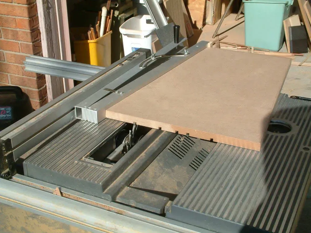

                                                                                            • 1456
                                                                                            Here are some construction photos:
