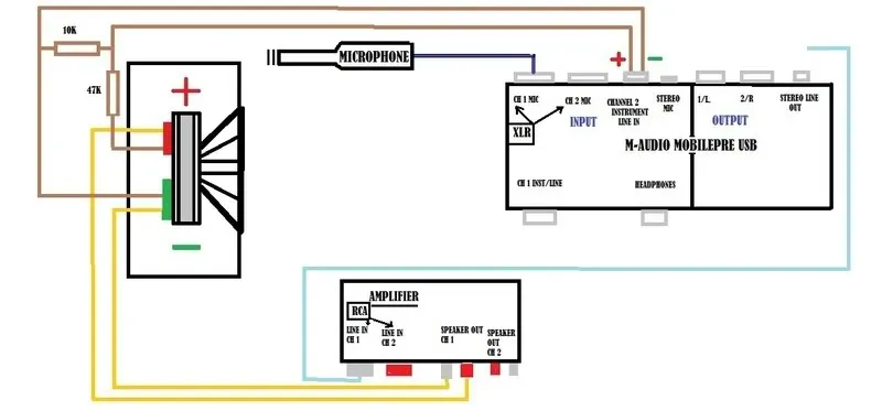

    Hi Guys,
    I've got JustMLS running through an M-Audio mobilepre USB and a calibrated ECM8000 microphone. I'm pretty sure it's wired up ok, because it seems to be working - Here's how it's wired up:

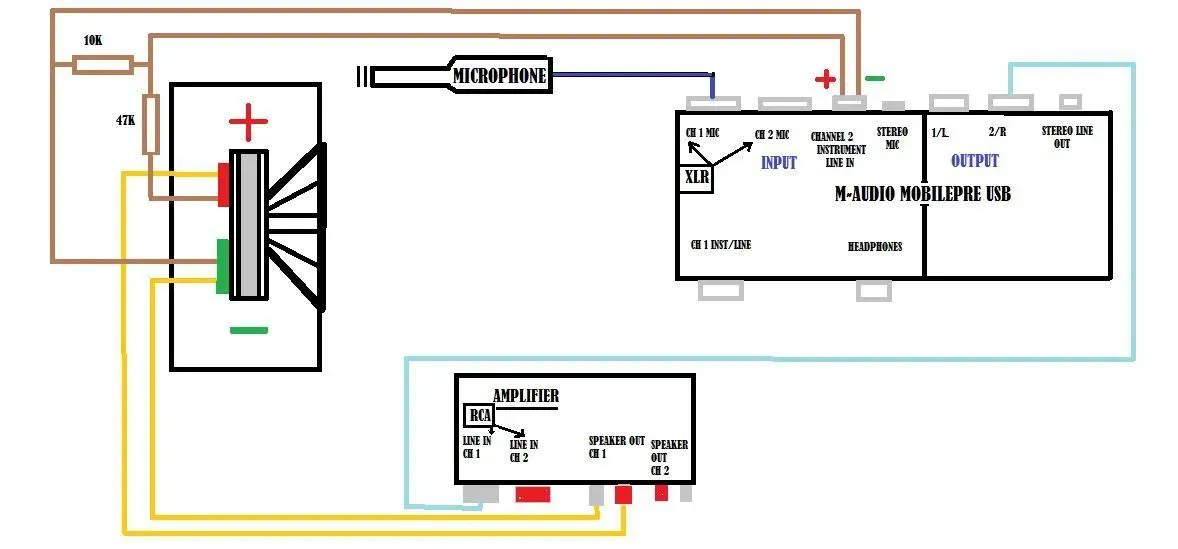

    I'd like to calibrate it properly for two channel mode, but the manual isn't very clear. Here's a quote from the manual:
    "A more complex (but more accurate) way to calibrate is to connect the soundcard output
    to the right channel via a probe. The mic preamp is also connected to the soundcard
    output, it must however be attenuated before. The calibration this time will account for the
    transfer function of the mic preamplifier."
    I found some more info on the net about calibrating JustMLS, but it's quite basic:
    "For calibrating the sound card, I take the speaker output directly to the line in, set the levels, and calibrate at various sample rates and lengths. When you get a good calibration file ("Justmls.cal") make a backup. I've trashed mine a couple of times."

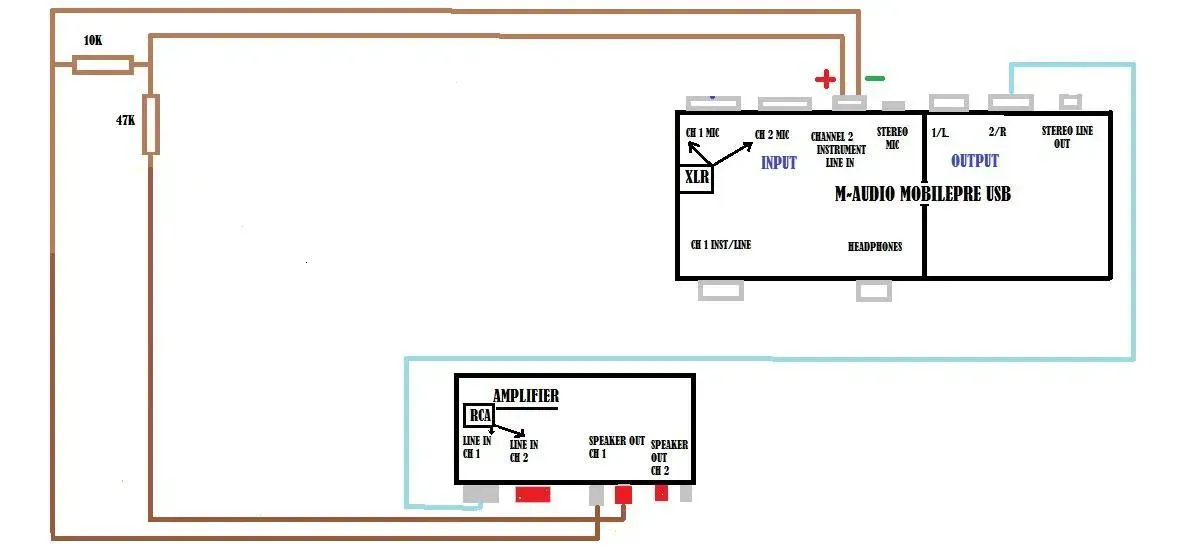

    I've drawn a picture of how I think it should be calibrated and just wondered if someone could cast an experienced eye over it for me ?
    Does that look right ?
    Thank's in advance.
    Matt

    • fjhuerta
      • 1140
      JustMLS can be used with any sound card. I've used with with 3 different ones with no issues.
      I checked out your wiring and it seems to be correct. In order to calibrate JustMLS, what I do is - I short the input and output of the soundcard, run the calibration and level procedure, and then connect everything the way you described on your first image.
      Are you adjusting the time-of-flight parameter and using the 2 channel input, both on JustMLS? That was my main issue when using JustMLS, and yeah, I got incomprehensible graphs. If you don't set up the correct delay (in meters or miliseconds) and gate the signal (usually around 4 ms) you are going to get ugly results...

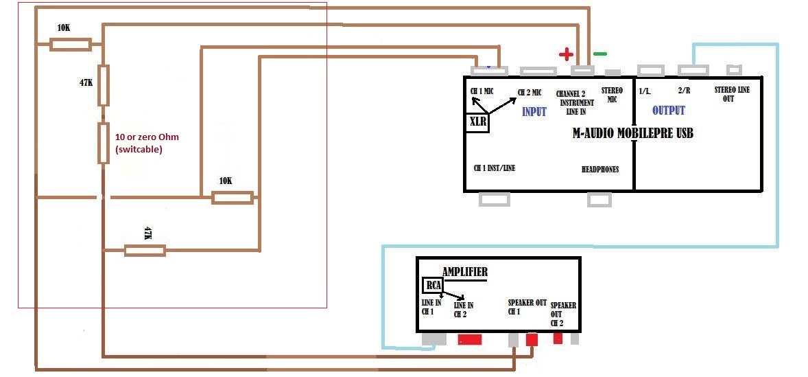

        This is how I do it (on a M-Audio Fast track PRO)
        Everything inside the red square is my "jig". The 10 ohm resistor is needed when measuring impedance.
          Thanks for checking my wiring. At least i'm doing something right
            Click image for larger version  Name:	M-AUDIO_pro.jpeg Views:	4147 Size:	90.8 KB ID:	856002
            Ah, that makes sense. I will have to re-design my jig to be like yours. Thanks very much for the circuit diagram

                    Yes, the first diagram you sent to me looks exactly like what I have for my setup. You’re good there, I think. It was this one:

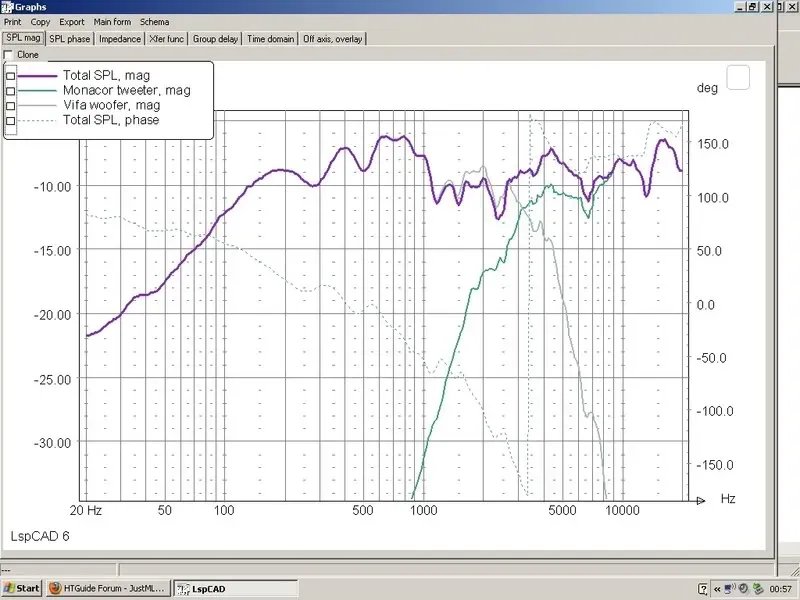

                    I do think that you should post some pics of what type of measurements you’re getting. We can help more if we see what you are seeing.
                      Ok, i've managed to upload some screen shots, but i'm not sure if they will tell you much. I will get some better screen shots (using the Windows screen print function) when I next get the measuring gear set-up.

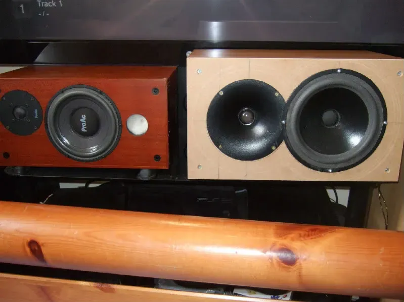

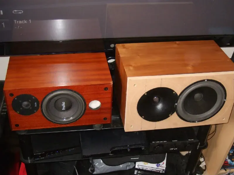

                        Here are a couple of pics of the speaker. The one on the left is a Proac studio 100 (nice speakers)

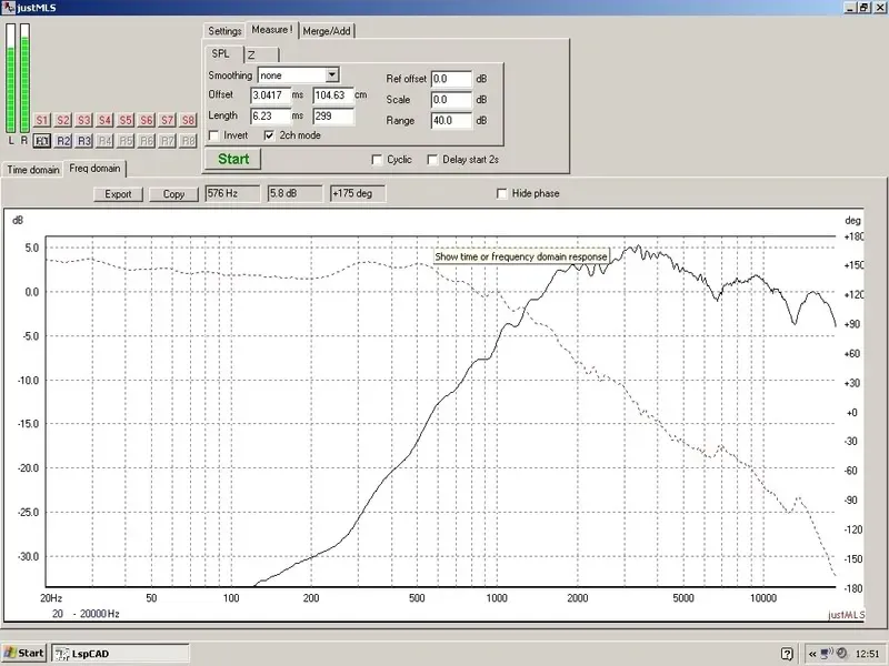

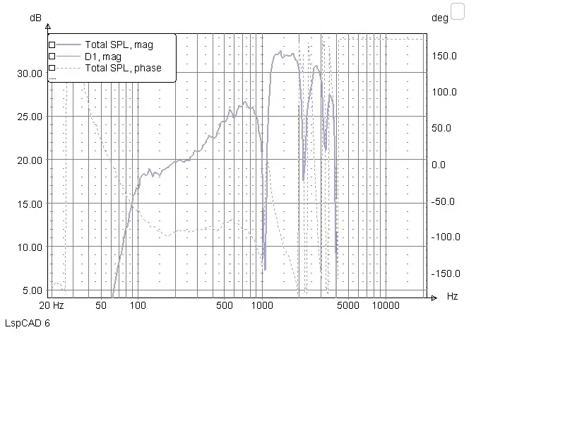

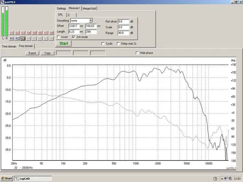

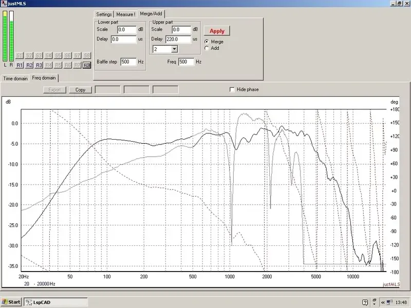

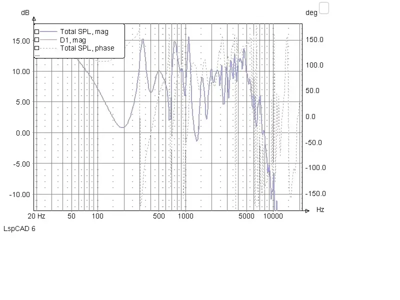

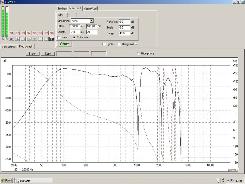

                        And here is a shot of the 1 meter midbass measurement:
                        Here's the nearfield measurement:

                        • JonW
                          • 1601
                          Hi Matt,
                          Those pics will help (I think). To be honest, I cannot pinpoint the immediate problem but I can take a stab at it.
                          As long as you have everything hooked up correctly, perhaps you are not getting enough signal/sound to the mic and computer. The far field plot looks really noisy. Like perhaps you’re just recording noise and not the output of a driver. You know how you adjusted the MobilePre knobs to get a good signal, but not get into clipping? You also need to do the same thing in the JustMLS program. There are level meters in there. Make them read a good, high signal without clipping.
                          The mid drops off above ~5,000 Hz as we might expect. But we might also expect it to drop off below ~200 Hz, which it does not seem to be doing. Not that measurements are valid below ~200 Hz but if you look at the example plot I linked to, you could see a drop off in my woofer.
                          The magnitude of your signals versus drop offs look about right, I guess.
                          It would be helpful to see the tweeter measurements as well. We will have a better expectation for the tweeter response. It should be flat well above 10,000 Hz and drop off below ~1,000 Hz, all well into the range of good measurements.
                          Alternatively, you could have the noisiest, least flat driver ever, but I doubt it’s that.
                          Another alternative is that your near field looks more like we might expect and so you need to adjust parameters for the 1 meter distance. Except those dips at ~1.1k, ~2.2k, 3.3k are pretty extreme. (1.1 -> 2.2 -> 3.3 may tell us something.) My first thought there was maybe metal cone resonance, but you said it’s paper. I really don’t know.
                          Also, keep in mind that I really have close to no idea what I’m talking about. You’ll be better off if you get help from someone more knowledgeable. Which means pretty much any idiot walking down the street.
                          Sounds like a cool, fun design. Good luck!
                          -Jon
                            I wonder why it's not dropping off below 200 Hz ? Does anyone here have any idea ?

                                      Finally had a chance to try some more measuring.
                                      Here's the tweeter at 1 mtr:
                                      Here's the 1 meter midbass measurement:
                                      This one is 5mm from the midbass:
                                      This one is nearfield and farfield just before pressing the 'Merge' button:
                                      I had to set the delay to 220 to get the phase to line up.

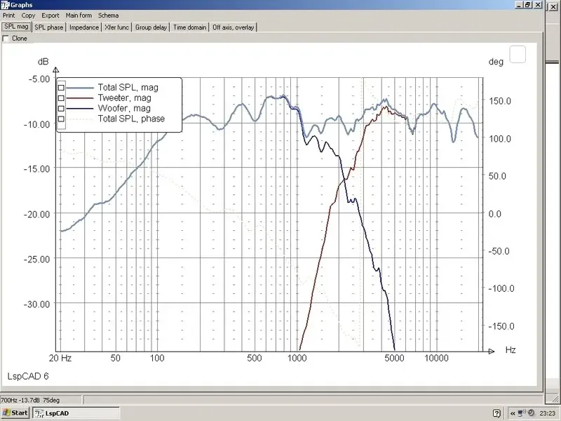

                                        This is my first attempt at a crossover. It's first order electrical for the woofer and tweeter. I want to keep the crossover as simple as possible because i've heard a complicated one can suck the life out of the speaker.
                                        Does anyone know what would happen if I used a second order electrical for the woofer and kept the first order on the tweeter ? Just wondered if it would help fill in the notch between 1000Hz and 4000Hz...

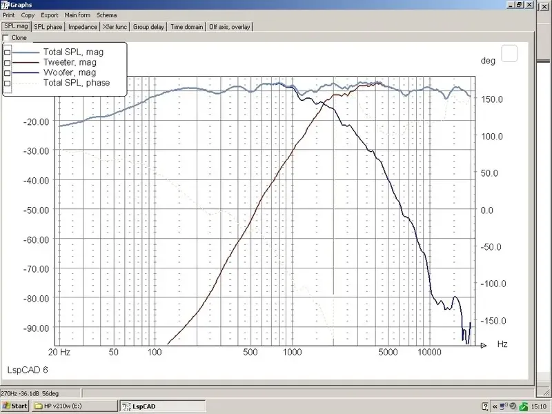

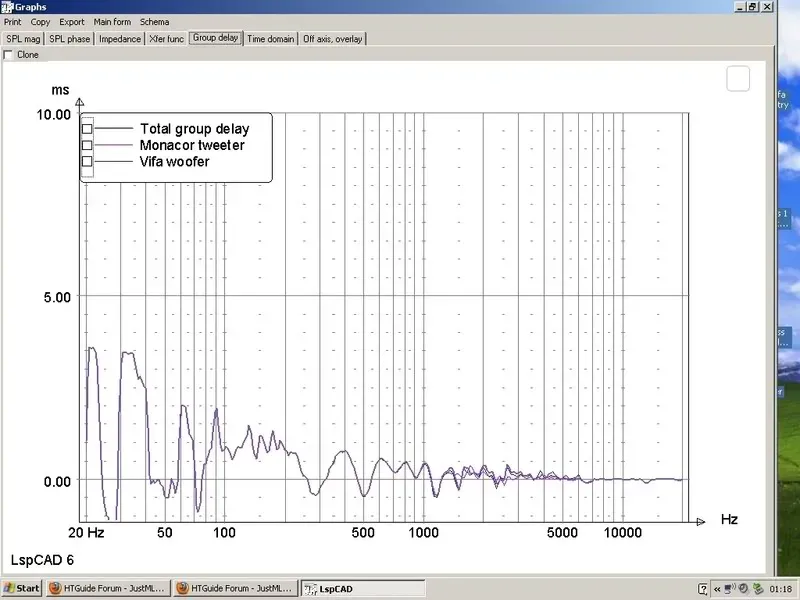

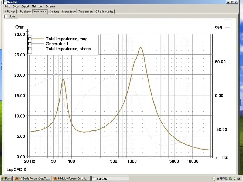

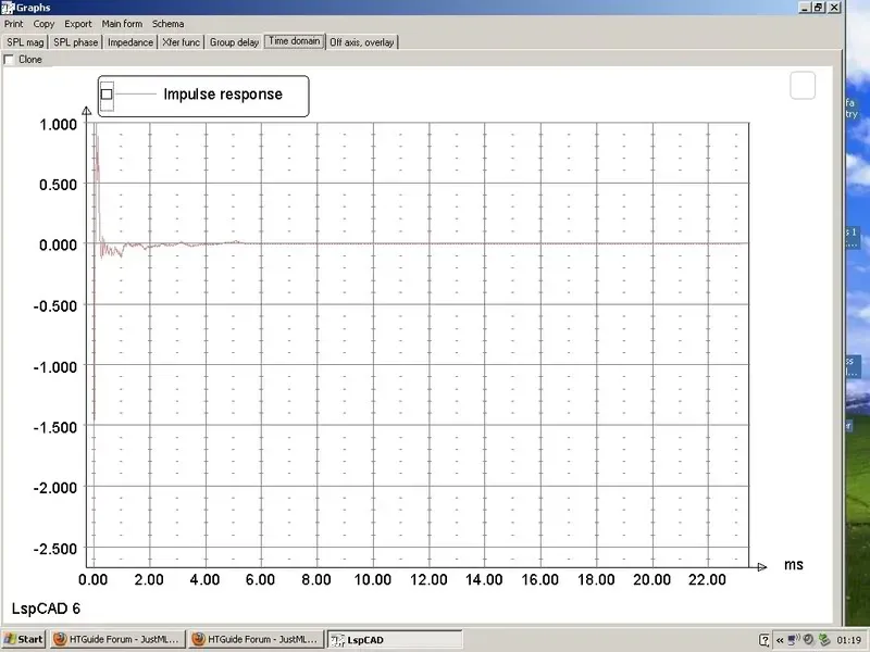

                                        • fatmarley
                                          • May 2011
                                          • 45

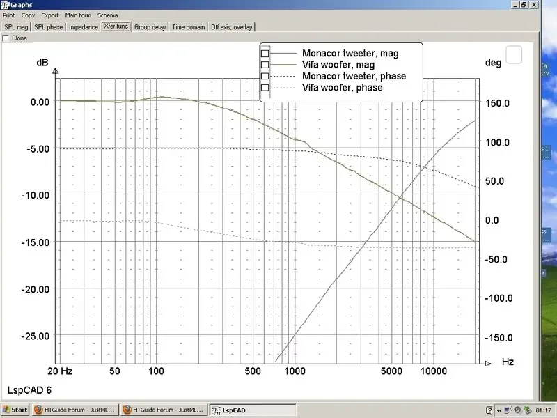

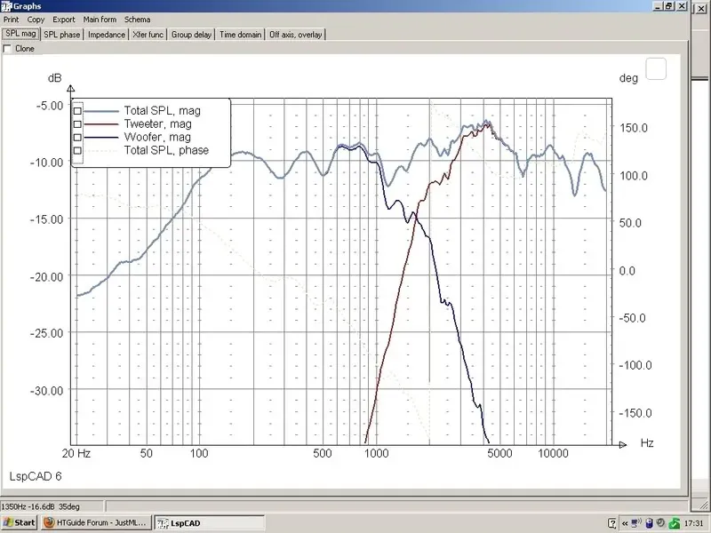

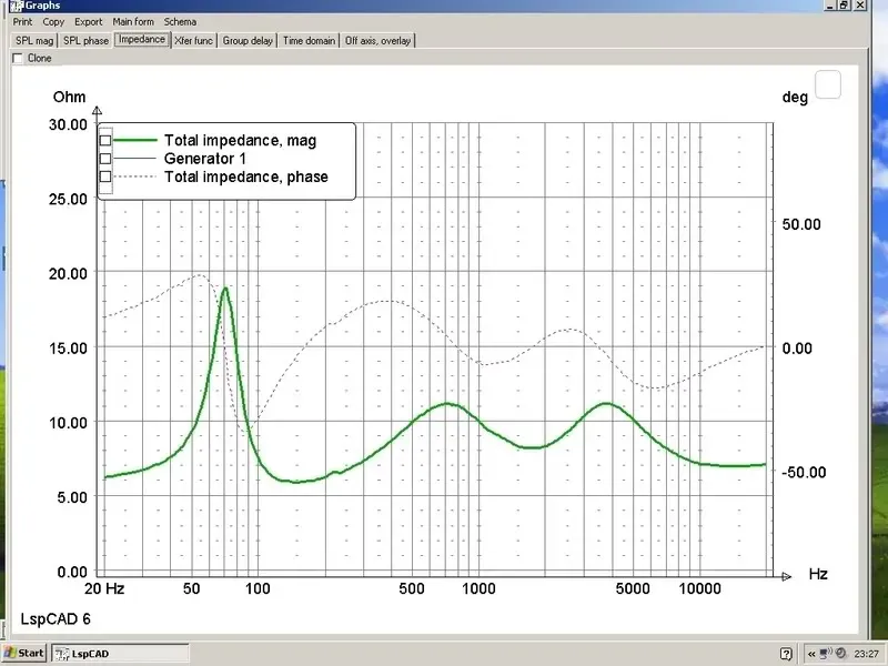

                                          Here are all the graphs from LspCAD:

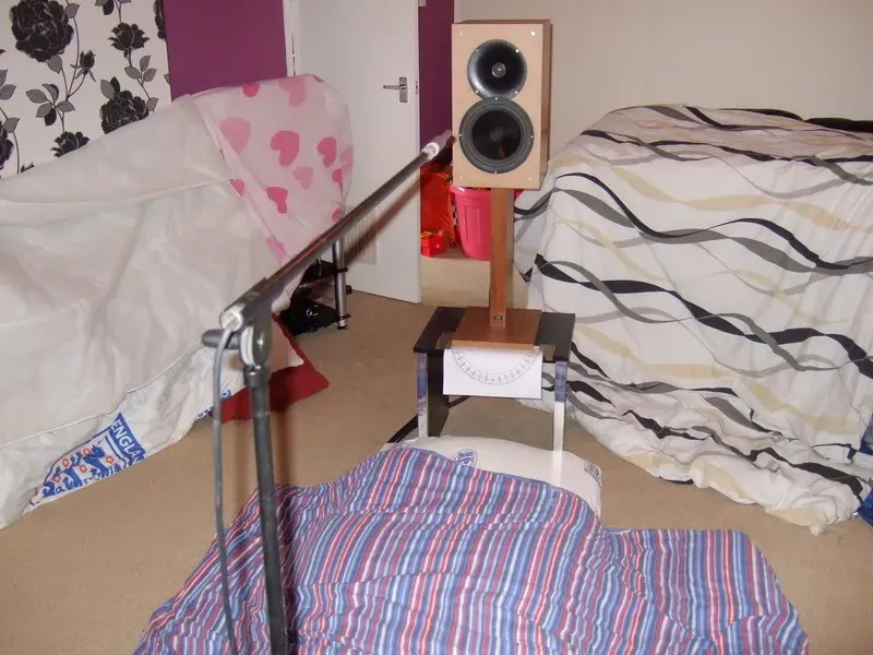

                                              One more picture - This is my measuring set-up:

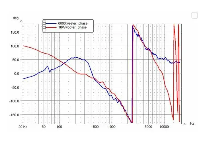

                                              • JonW
                                                • 1601
                                                Hi Matt,
                                                Your 1 meter measurements look excellent! Congrats. :T The most annoying part of speaker building is now behind you.
                                                I’m not sure why the 5 mm measurement looks funny. But the 1 meter T and W look great, so go with that.
                                                Crossover philosophy can be very personal. So take my thoughts with a grain of salt. I have only 1 complete project under my belt. But for whatever they are worth…
                                                I think that you could have the frequency response flatter. I might try to knock down the hump at ~700 Hz and bring up the dip at ~2,000 Hz, to be on level with the tweeter at 4,000-15,000 Hz. Although a BBC dip can be pleasant. As can a lot of bass, but my guess is that the bass hump will sound good at first but bloated after a lot of listening.
                                                Try to get the phases of the 2 drivers to match up better. It’s most important for the frequencies at which both drivers are playing and can be heard. Let’s say ~500 - 5,000 Hz, roughly. Below, as an example, I have a pic of the phase overlap for the Spassvogels. I got them to overlap pretty decently. For me, the speaker really came alive when I got the phase under control. That’s what jumped it up a level to “wow.”
                                                If you're up for it, also take measurements at 30 degrees off axis. After you have a crossover that looks good, plug in the 30 degree measurements. The tweeter response will drop above ~10,000 Hz. But if everything else looks good, you're in good shape for off axis issues. My guess is that many people skip this part.
                                                Also if you're up for it, you might want to try to get rid of the impedance hump at 1500 Hz. I found that it helped the sound a bit. Here too, I think that many people skip this part. See below:
                                                Regarding simple crossovers sounding better, I’m not buying it. If there are issues to address (peaks in frequency, poor phase overlap, impedance jumps, etc.) it might sound better if you address them in the crossover. Then again, some people prefer the simplicity of a single driver speaker.
                                                In the Spassvogel crossver, I have 2 LCR filters. Looking at the crossover, it may seem overly complex and as though the sound is going to be sucked out of the speaker. Some people have said it looks like that. However… I clipped together test crossovers and listened to things both with and without each LCR filter. I preferred the sound of having one by a significant margin and the other by a small bit. They are there for a purpose and they seem to help. Listening impressions on the LCR’s are here in post 459:
                                                But don’t take my word for it. Try it for yourself. Clip together parts for the simple crossover. Have a listen. Then do the same for a more complex crossover. Which do you prefer? Go with whichever you like better.
                                                Excellent progress, Matt. Good luck! :T

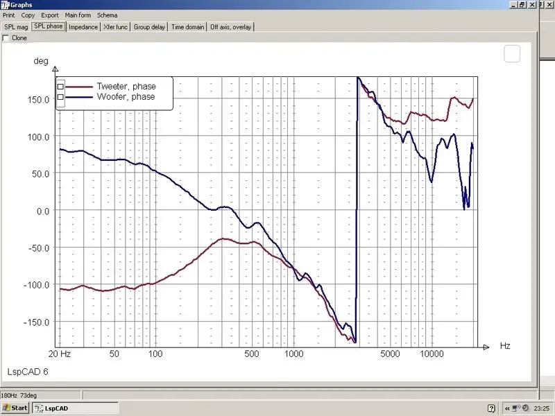

                                                • fatmarley
                                                  • May 2011
                                                  • 45
                                                  Thanks for the encouragement Jon. I bought some crocodile test leads after reading your thread. I thought it was a good idea for experimenting with different components.
                                                  I remember someone saying getting the phase right is vital, but I don't know what to do to improve it. I don't suppose you can remember ? I honestly haven't got a clue.
                                                  I took some some measurements at 15, 30, 45, and 60 degrees (you can just see the protractor that I printed, under the speaker stand) I put a nail in the base of the stand, in line with the tweeter. The girlfriend would kill me if she found out I put a hole in the table lol
                                                  • JonW
                                                    • 1601
                                                    Hi Matt,
                                                    You know how, in LspCAD, you have the crossover. You change the value of a component and then look to see how it changes the frequency response? Same thing, just look at the phase plot. Change component values (or even the presence or absence of components) to get the phase looking good. Most likely you may arrive at a point where you can have either the phase look better or the frequency response. Frustrating. Pick your poison. Have a listen each way and see what you think. Maybe you'll get lucky and the good phase and good frequency response and good impedance all coincide. But if it gets too frustrating, have a drink, relax, and remember that it’s not nearly as frustrating as trying to get good measurements.
                                                    Also check for the reversed tweeter null. If it's deep, you're onto something good.
                                                    You're lucky that the ladies pretty much never stop by here. So I think that your secret is safe.

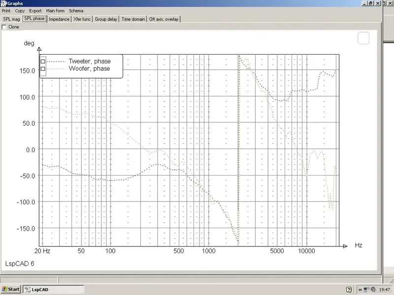

                                                    • fatmarley

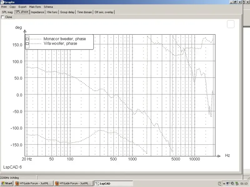

                                                      • May 2011
                                                      • 45
                                                      I couldn't get the phase to line up with a first order crossover, so I tried a second order.
                                                      The frequency response isn't perfect, but the phase looks far better than before.
                                                      Do you think the phase is good enough ? I'm going to clone this attempt and keep trying to improve it. I wonder if a zobel would help or make things worse ?

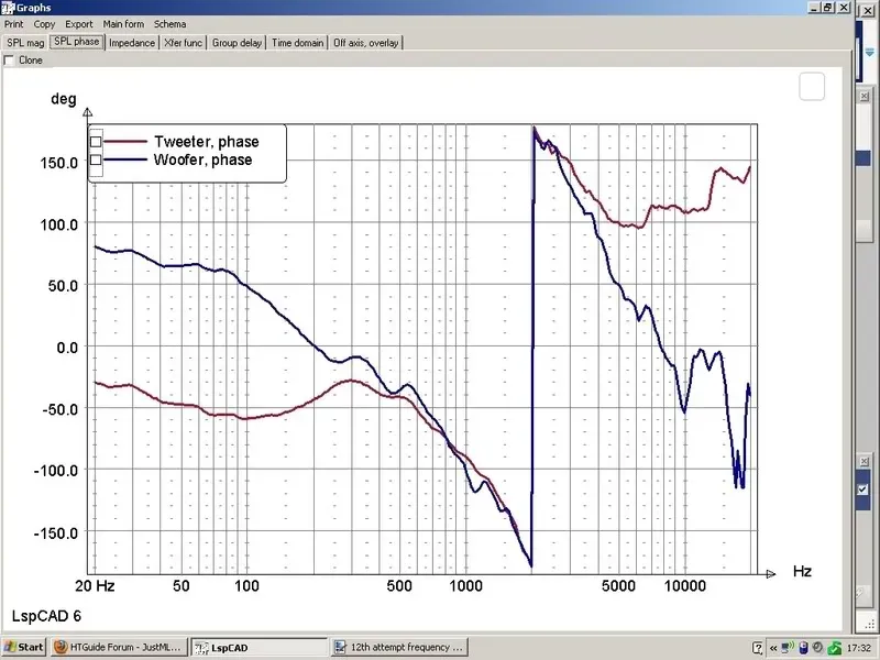

                                                            • fatmarley
                                                              • May 2011
                                                              • 45
                                                              Mike,
                                                              Going by what Jon says and his example. It looks like you need to tidy up the phase a bit more.
                                                              Here's my best attempt (second order) :
                                                              I've had better phase, but the frequency response was quite bad.

                                                                Right - I've got three or four 2nd order crossovers shortlisted now. They all have good phase and impedance and the frequency response is pretty flat on all of them (well, as flat as I can get without lots of notch filters).
                                                                I've ordered loads of components, so I can experiment. Must of spent around £300, so I hope it's going to be worth it :E
                                                                Here's the graphs of one of them:
                                                                I'll report back with my opinions when I've had a good play with the various crossovers...
                                                                • JonW
                                                                  • 1601
                                                                  Hey Guys,
                                                                  Sorry for the silence. The kid, work, etc. sometimes get in the way of speakers. It’s no excuse, I know.
                                                                  Originally posted by CraigJ
                                                                  Matt,
                                                                  You are in very good hands. Welcome back Jon, you've been missed.
                                                                  Craig
                                                                  Craig!!
                                                                  How’s it going! Yeah, it’s good to be back a little bit. I still don’t have enough time to pick up my half finished speaker project. But at least I can read and type a little. What are you up to? What’s the latest project?
                                                                  Matt-
                                                                  You’re coming along wonderfully! The phase in post 27 looks excellent. Don’t change it.
                                                                  For post 32, I’d say that your phase still looks super. The impedance also looks excellent. I’ve seen better. But I’d say that most are worse. So you’re in great shape for phase and impedance.
                                                                  For the frequency response plot, I don’t like the dips at 300, 500, 7,000, and 13,000 Hz. But, eh, they’re in the raw driver measurements. So I don’t think that you can do too much about them.
                                                                  The only thing in there that I might suggest changing at this point is the woofer level. Can you knock it down about 2 db? Alternatively bring up the tweeter level? If you have a tweeter padding resistor in the circuit, try decreasing the value by ~2 ohms. I’m thinking that the extra output between 400 and 1000 Hz may sound a little off after long listening. But it might be fine. I doubt it will sound bad right away.
                                                                  Also, try reversing the tweeter polarity in LspCAD and see if it models a good null (20+ db deep or more).
                                                                  Your next step is, I would say, the correct one: Buy some parts, clip things together, and have a listen. I found that it helped when I did that. I also changed component values a bit and listened some more. For example, if there was a 10 uF cap, I tried it with 8 and 12. I did that with every part of the crossover. Some of the values changed. And it sounded better, overall. Interestingly, when I plugged all those new values into the crossover, the plots of frequency response, phase, and impedance barely changed. LspCAD is wonderful, as is a crossover model. But at some point you have to use your ears. Besides, what one person really likes, another may not.
                                                                        Yea I know what you mean. I found a cure for that

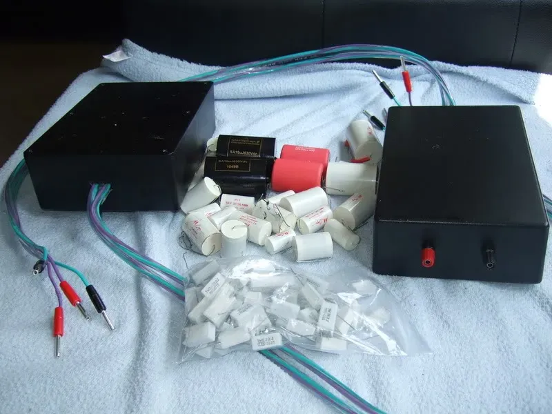

                                                                        Just tried that and I have a good null
                                                                        I've got the crossover boxes wired-up ready. All i'm waiting for is the inductors.
                                                                        Here's the caps/resistors and crossover boxes:
