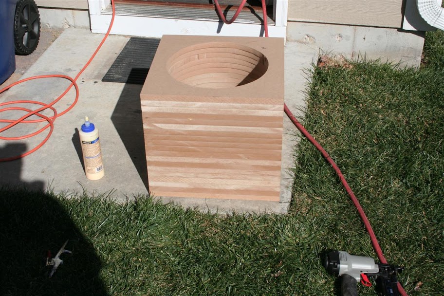

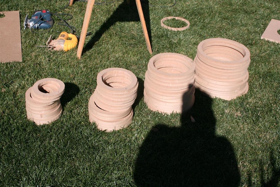

                                                Cutting Done!
                                                I made some good progress the last few days. I ended up just cutting the circles with a jig saw. I attached them to a saw horse at the center point then basically had to hold the jig saw still and rotate the wood about the center point. Far from perfect, but not too bad for what I'm trying to accomplish.
                                                Here are the pieces cut out before I glued them.
                                                Here is the square section all glued together.
                                                I actually made it in 5 sections so I could more easily carry it downstairs. Once it is there I will glue the sections together and install the speaker. Since my kids were able to help me with some parts of it I thought I would include them in the picture. They also give you a good idea of how big it is. They like to call it the volcano and are trying to convince me to let them paint it brown with red/yellow/orange flowing out the top...
                                                I've got a bit of sanding on the outside to make it a viable addition to our theater, but I'm going to set it up and see how I like it before I spend a lot of time sanding and painting it. So far it's doesn't have a good SAF rating. We'll see how that ends up.
                                                -Ryan

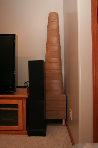

                                                        I was able to get the sub-woofer installed and give it a workout today. Here are the pics of the last part of the build.
                                                        And the final, albeit unfinished product.
                                                        That is a 40 inch tall TriTrix in front of it, just to give you an idea how tall it is.

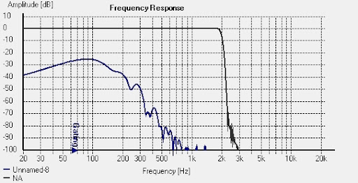

                                                        Here is the frequency response I measured.
                                                        The blue line is the input from the speaker. I think my measurements are a little off as I don't have a calibrated mic, and the response of the mic I do have shows a drop off of about -3dB under 100Hz. Taking that into account it's very close, but not quite, the F3 of 30 I was hoping for.
                                                        As for listening...it is incredible how much better it sounds than the 8in HTIB subwoofer I had before. Previously, when I listened to the beginning sequence in Bolt or the fighting sequences in IronMan 2 the deep subwoofer sounds were atrocious. With this thing the sounds are tight and very deep. I had to open the doors adjacent to the theater area because they were rattling in their frames. Although at the very low end (~20Hz) it runs out of ability and gives some negative sounding vibes. My wife was very impressed and asked "Is this how these movies are supposed to sound? Are they really supposed to go this low? I can FEEL them!" I politely told her that it was way closer than what we had before, but we weren't quite there yet, and that $40 wouldn't get us there. But, I've got to say, I would have never thought that $40 (for the driver and wood) could have sounded so good.
                                                        I think I need to take it outside again and give it a good sanding to make it look good, maybe add a little paint, then we will probably keep it till I get my Dayton RS 15 incher. In the mean time I'm going to keep listening to it and get it broken in good then measure it again.
                                                        -Ryan
