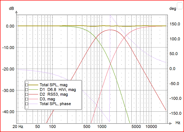

                              Jon, while you've been gone, a few of us have been playing with the Duelund math. Here's what I posted in another thread. It makes it really easy to generate target files with the LspCAD transfer function component. It also opens the door for using filters other than LR2 and doing 'asymmetrical' designs. The 'big concept' I think is duplicating the poles (either highpass or lowpass) on all the drivers.
                              Back to the Duelund 3-way thing, we've been making this way too hard and
                              Steen Duelund, mathematician that he was, didn't help make it easier for
                              us mathematically challenged DIYers. I had some time today before the
                              baseball game and I had a lightbulb/eureka moment. I checked it out in
                              LspCAD and it appears to be true.
                              The whole thing is based on LR2 filters.
                              Pick the two crossover frequencies F-low and F-high.
                              The midrange has an LR2 highpass at F-low and an LR2 lowpass at F-high.
                              That's 4 poles total.
                              The woofer has an LR2 lowpass at F-low (2 poles). You need two more
                              poles to keep it in phase at all frequencies so you add another LR2
                              lowpass at F-high.
                              The tweeter has an LR2 highpass at F-high (2 poles). You need two more
                              highpass at F-low.
                              That's it. Simple huh?
                              I haven't checked the 4-way yet but I'm guessing it's the same sort of
                              thing -- adding LR2s (either highpass or lowpass) at the other
                              frequencies to get a total of 6 poles for each driver. Woofer = LR2 at
                              woof/lo-mid, LR2 at lo-mid/hi-mid, LR2 at hi-mid/tweet. Etc.

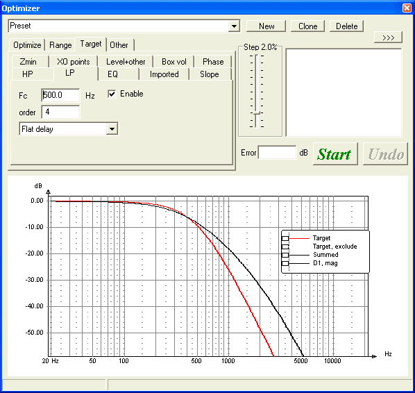

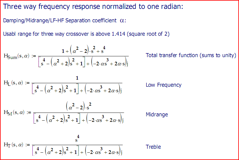

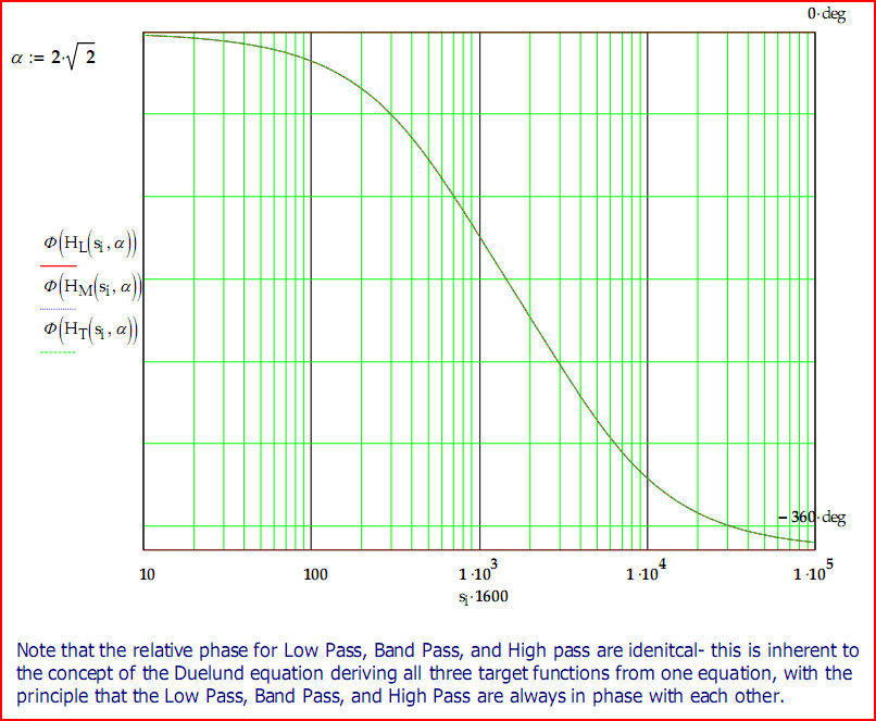

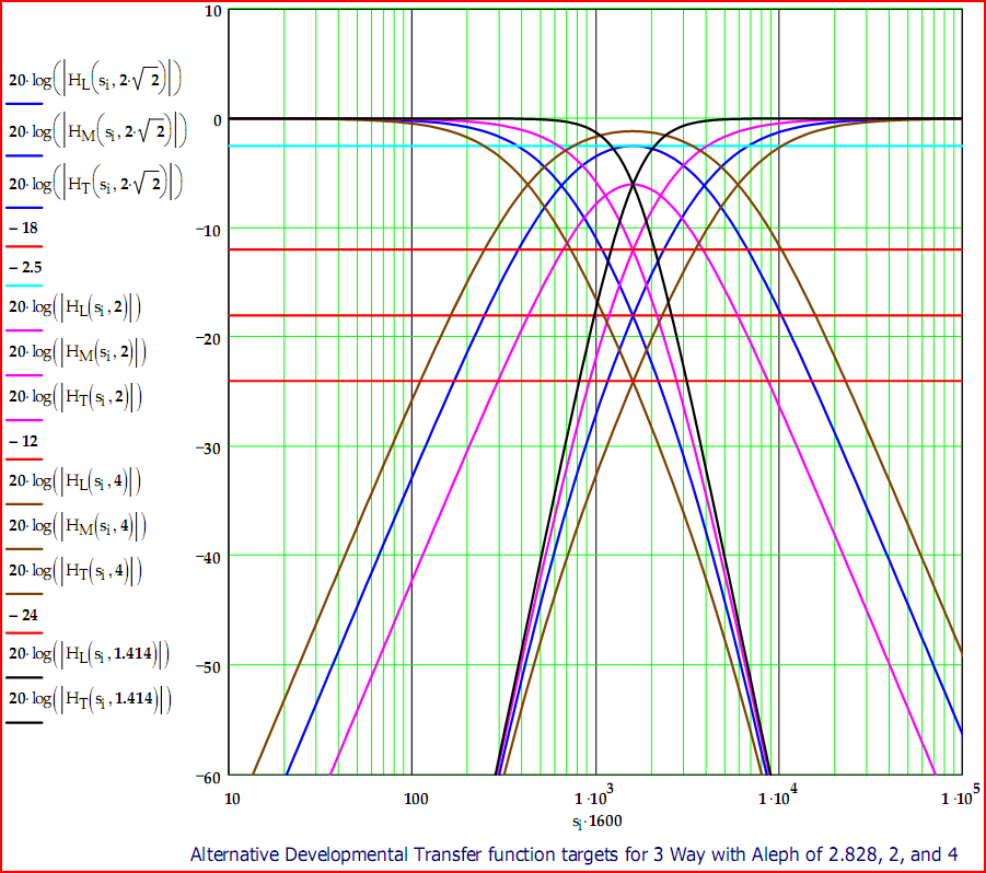

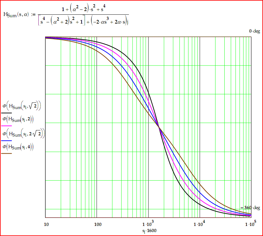

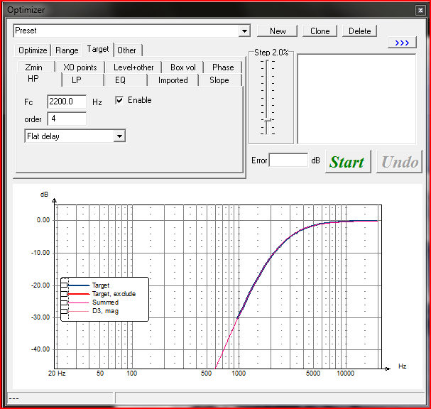

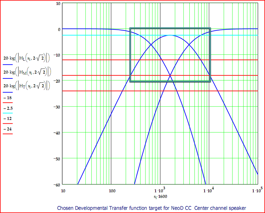

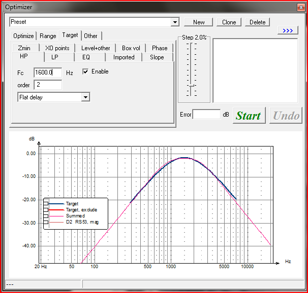

                                  Well, I would never discourage taking what ever road gets you to where you want to go, but let's recall my original description.... using LspCAD to create a target model...
                                  If successfully implemented, the resulting crossover will have 2nd order bandpass characteristics for the midrange, and roughly flat delay Bessel 4th order functions for the woofer LP and tweeter HP. Note that depending on the value of the damping coefficient aleph, much different midrange spread and overall levels are possible- transfer functions that may be very difficult to realize with practical drivers. This acoustic target was chosen for the specific driver picked - particularly the Dayton RS52AN, which has a rather flat, wide bandpass.
                                  This initial concept proposed a center frequency of 1500 Hz; this was revised to 1600 Hz to ease the low frequency requirements on the RS52AN. Because the 4th order LP and HP functions with this aleph are bessel 4th order functions, with the range of acoustic targets already built in to LspCAD, it should be possible to realize one of the more usable Duelund alignments in a three way configuration, without a MathCAD generated reference target. This is because Ingemar offers flat delay filters (minimum group delay) in both 2nd and 4th order. Flat delay is a characteristic of the lower order coefficient Duelund alignments. It turns out this is also a desirable approach because a "pure" Duelund acoustic function mandates that the acoustic centers of the drivers be aligned at equal distance from the listener. This is not possible with a flat baffle cabinet like the PE enclosures or other conventional box enclosures. I suspected that by using the midrange function aligned to achieve a flat net SPL response after the woofer and tweeter had been aligned to the necessary transfer function, it might be possible to achieve something very close, if not exactly congruent, to a Duelund three way transfer function. This proved to be the case, fortunately.
                                  As a first step, the ability to realize this transfer function with "ideal" flat drivers was undertaken in LspCAD. This does not include having to use driver data with baffle step fall off and the other usual irregularities- those are dependent on the drivers chosen and the cabinet design. This is merely to describe the basic filter impelmentation and targets - much like the difference between a text book LR4 two way, and what you have to do in the real world to pull off the complete design.
                                  The basic target functions are derived from the LspCAD Flat Delay functions- the LP target is the Flat Delay 4th order with a Fs of 1000 Hz, which hits the target -18 dB level at ~1.6 kHz, and the HP Flat Delay target with Fp set to ~2200 Hz, again hitting the -18 dB crossover target at ~1.6 kHz.
                                  The initial midrange target is somewhat more difficult, as it must be generated from the combination of HP and LP 2nd order Flat delay targets; the LP set to 1400 Hz, the HP to 1600 Hz, and the target level adjusted for the peak at ~ -3 dB.
                                  After the LP and HP networks have been optimized to the Flat delay targets, and the bandpass likewise for the synthesized target, response is close, but still with a dB or so ripple- this is because the flat delay target is not exactly equivalent to the chosen Duelund (aleph = 2.82, but very close. The final step is to optimize ONLY the bandpass components, and setup the target as flat response between 200 Hz and 10 kHz, to bring the midrange passband into compliance.
                                  With the Duelund alignment chosen for the NeoD CC, with aleph = 2.82, these 4th order flat delay alignments for the high and low pass do the trick, and they're built in to LspCAD.
                                  For other designs, if a different value of aleph is used because of different driver capabilities for bandwidth, like one of the M12ta proposals I was kicking around, then I'll probably end up importing the MathCAD data into LspCAD. The Excel sheets you did would be fine for that kind of evaluation, too, and creating target data.

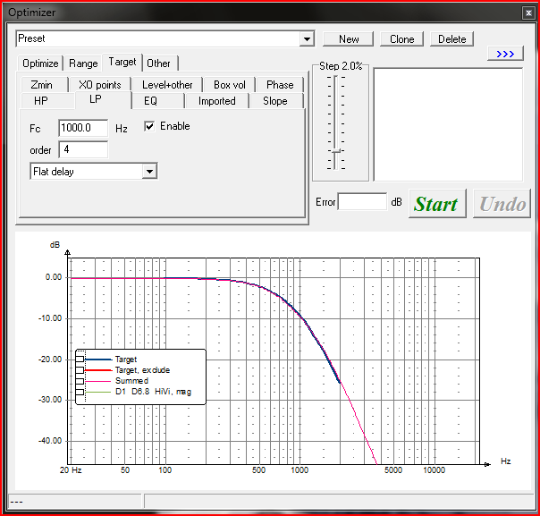

                                          Dang Jon, I hate to be a Padawan disagreeing with the master but that's just not right. It's really not even close to a Bessel4. It's two stacked LR2 filters at the two crossover frequencies.
                                          I wrote some Mathcad sheets (got an old copy from Danish and used this problem as a learning exercise) using the native S-plane math and used them to generate target files. Then I used those targets in LspCAD to optimize the frequencies of LR2 transfer functions. The LR2 frequencies of the three drivers were identical within the LspCAD precision and the errors from the Duelund curves were like a couple thousandths of a dB. Here are the notes I took at the time.
                                          Center frequency = 1000
                                          a = 2.828 (recommended by Steen Duelund)
                                          Approximate crossovers 400 and 2400 (eyeballed from the graph)
                                          Curves exported to .txt target files
                                          LspCAD optimization runs, optimizing Fc of LR2 filters to match the Duelund curves:
                                          Lowpass optimized from 20 to 5K (~ -60dB)
                                          LR2 lowpass filters at 414.2 and 2414.2
                                          Average error = 0.001843 dB
                                          Bandpass optimized from 20 to 20K (~ -50 and -40 dB)
                                          LR2 highpass at 414.2 and LR2 lowpass at 2414.1
                                          Average error = 0.001920 dB
                                          Highpass optimized from 200 to 20K (~ -60dB)
                                          LR2 highpass filters at 414.3 and 2414.1
                                          Average error = 0.002069 dB
                                          Conclusion: the Fc's of the filters on the three drivers is within the precision limit of the LspCAD active transfer functions to achieve the Duelund targets. The same Fc's should be used for designing all three filters.

                                            Just a followup with a pic I had saved. Duelund is in black, Bessel4 is in red. Fc is adjusted so they're -6dB at about the same frequency.

                                                    Equations and transfer function:
                                                    The Duelund style crossover, invented by the late Steen Duelund, (often referred to as the Mad Loudspeaker Professor) is a mathematic derivation for a three way crossover, using a shared damping coefficient aleph for each section, which sums in all cases to unity all pass, with a single phase rotation from the low frequencies to the high. By varying the value of the aleph coeffficient, different response types regarding the Low Pass and High Pass alignments and bandwidth of the midrange and it's level are described. With decreasing levels of aleph, the midrange element narrows in the range it covers and in level, and the network response can devolve to just a two way LR4 if the value of aleph is equal to the square root of 2 (1.414)
                                                    (Full set of equations, Fig 1)
                                                    In MathCAD the function HSum(s,α) defines the complete transfer function in terms of the frequency variable “s” and the damping coefficient “α”, with the following functions describing just the low pass, band pass (midrange), and high pass function.
                                                    All three functions (low pass, band pass, and high pass) are in relative phase with each other at any frequency, with a net total phase rotation of 360 degrees from the low bass to the treble, just as the phase rotation of a two way LR-4 crossover. In fact, as noted above, with aleph at 1.414, the three way devolves to a LR4 two way. High and low pass are 4th order functions, but with changing aleph, the pole separation changes and much slower initial rates may be seen at the turn-over frquencies- with some values of aleph, this INITIAL rate may be close to an LR2. The ultimate slope is still 4th order, though.
                                                    In the next figure the amplitude plots for LP, BP, and HP are plotted with several coefficient values: the square root of 2 2, 2, 2 X the square root of 2, and 4. This clearly illustrates the progression of the midrange bandpass level and width, along with the change in LP and HP alignments as the Q is lowered.
                                                    The case for α = 2 results in the sharpest cutoff slope that has no ringing in the step function, but the peak of the bandpass level is about -6 dB, and the HP and LP functions crossover at -12 dB; this requires a fair amount of bandwidth of the woofer and tweeter, but minimizes the workload on the midrange.
                                                    The case for α = twice the root of 2 is the variation I tried for the NeoD CC; the midrange level rises to -2.5 dB, and the crossover of the LP and HP are at -18 dB. The summation of the LP and HP at 1800 Hz adds to the midrange output to bring the level to unity- as long as the correct phase relationship is maintained in the realized speaker.
                                                    The last example for α = 4 shows the midrange/bandpass level reaching within 1 dB of the unity level, with reduced requirements of the bass and treble drivers. But the requirements here on the midrange are quite substantial- considering what is required for relatively flat summation, uniform response seems required to about the -15 to -18 dB level- which for the midrange is at least 200 Hz to 13 kHz. Few drivers can approach this requirement.
                                                    The red marker lines at several dB points (-12 dB, -18 dB, and -24 dB show the LP and HP crossover points as the alignments produce a wider and higher bandpass level, but at the same center frequency. This example was created with a nominal center frequency of 1600 Hz.
                                                    (Figure 2).

                                                    What does the phase response look like for these variations in the damping coefficient? This is shown below, where the a function extracting the phase from the transfer function is plotted for the same four sets of coefficients. The trace colors used for each coefficient example are the same as shown in the graph above- note that the phase shift shape for the square root of two α is the same as for the conventionally calculated LR4. With higher values of α, the phase turn is slower through the transition region.
                                                    (Figure 3)
                                                    That the bass, midrange, and treble are in the same relative phase at all frequencies is shown in the following graph, plotting the extracted phase for LP, BP, and Hp for the case of α = 2 X the square root of 2. The three plots overlay each other.

                                                    LSPCAD Trial
                                                    The straight forward way to generate the amplitude targets in LspCAD would have been to export them from MathCAD in a text form file, which is readily done- but inspection of the high pass and low pass for the alignment I chose indicated some standard available functions may suffice. Verifying this in practice would give other LspCAD users an opportunity to examine this concept without requiring either MathCAD or Excel to generate targets, a potentially useful outcome. Examining the calculated LP amplitude curve, the attenuation is ~2.5 dB at 400 Hz, -11 db at 1,000 Hz, and -18 dB at 1600 Hz. Examining the LspCAD target functions, a fairly close fit in the critical midrange area is the Flat Delay 4th order with a turn-over frequency of 1 kHz; the level is a bit too high at the 400 Hz area, so the required amplitude of the midrange may be reduced there, which could be of benefit. Considering the the “critical” bounding box as described above, the behavior below the -20 dB level was not considered very important. This match was not completely exact, but close enough that I considered it worth evaluating- it would alter the curvature of the phase and amplitude slightly in the lower midrange, but could ease the workload on the midrange for flat summation.
                                                    (Figure 6)
                                                    The high pass target selected was a flat delay 4th order with nominal fc of 2200 Hz, again for the same reason, the relative levels in the area of midrange summation, with a -18 dB point at the design center frequency.
                                                    (Figure 7)
                                                    The midrange targets used for component calculations were chosen just to get component values in the ball park, as previously described.
                                                    (Figure 8)
                                                    The final midrange component values were optimized then to achieve a flat transfer function with the LspCAD optimizer. The results are shown in Figure 9, with the plotted LP, BP, and HP functions, and the summed response.
                                                    (Figure 9)
                                                    Not quite a perfect summing, with the tiniest bit of ripple, but then with real loudspeaker drivers and cabinets you would be incredibly charmed to get even close to this. The total phase transfer function follows a single slow 360 degree all pass function as expected, and most importantly, summing behavior in the critical region appears to be quite good. As such it appears quite usable for the system development, so I went ahead with this as an example anyone could use with just LspCAD, and with the value of “α” I think may be most commonly useful with available drivers for a three way system as an example.

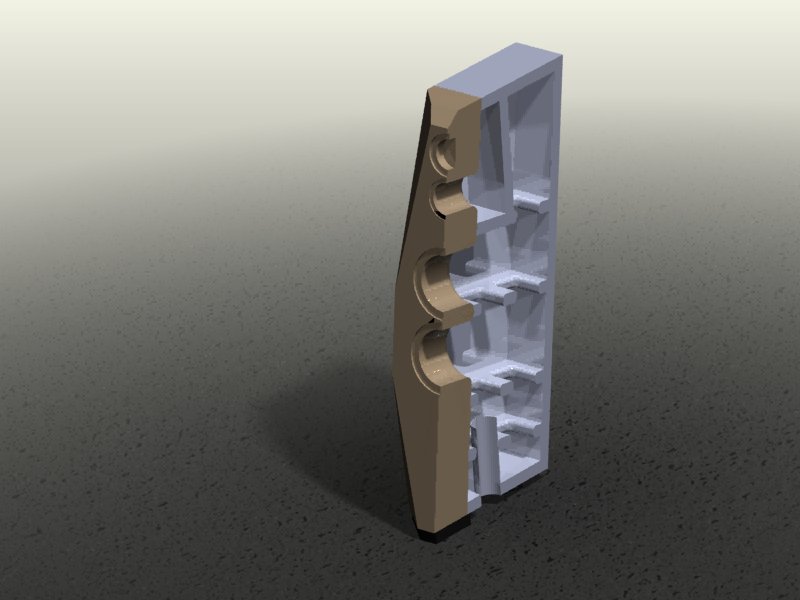

                                                                Just to indicate something more representative of what the SDX-2 Ardent will be configured, here's a screen shot in the current CAD development process. The internals are NOT based on the Soup clone, as Pele drew above (which in turn is based on the Avalon Opus Ceramique), but rather on structural details and methods more derived from the source. There will be detailed piece part drawings prepared, so as ThomasW says, I'm pushing too many pixels and not making enough sawdust. However, it's wise to plan once, design twice, measure three times, and cut once. :W
                                                                This is only a screen capture during design, not a rendering, but the differences should be obvious.

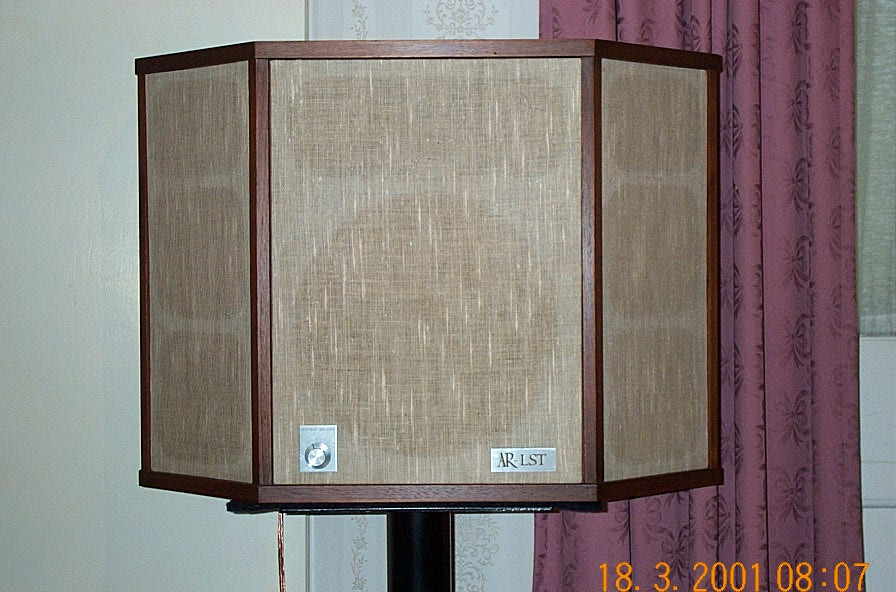

                                                                              I have a long history of doing speakers that are not straight boxes. :W My wife made me get rid of the last ones I had in the early 80s, she couldn't deal with the size (dual 10 woofers, four way with 6" midrange, dome midrange, and 3/4" MB dome tweeter, in a faceted front panel cabinet; front panel was about 4" thick. Anything sound familiar here? By the way, I got rid of those by giving them to Charles Hansen, who used to work for me when he was a physics student at CU. The rest is history.
                                                                              For that time, and my age (very early 20's), the AR-LST "clone" was a sophisticated project to do, using Long dome mids and Long tweeters. It's not a beginner project; the SDX-2 Ardent isn't either, unless one is really up for a cruel learning curve! :W
