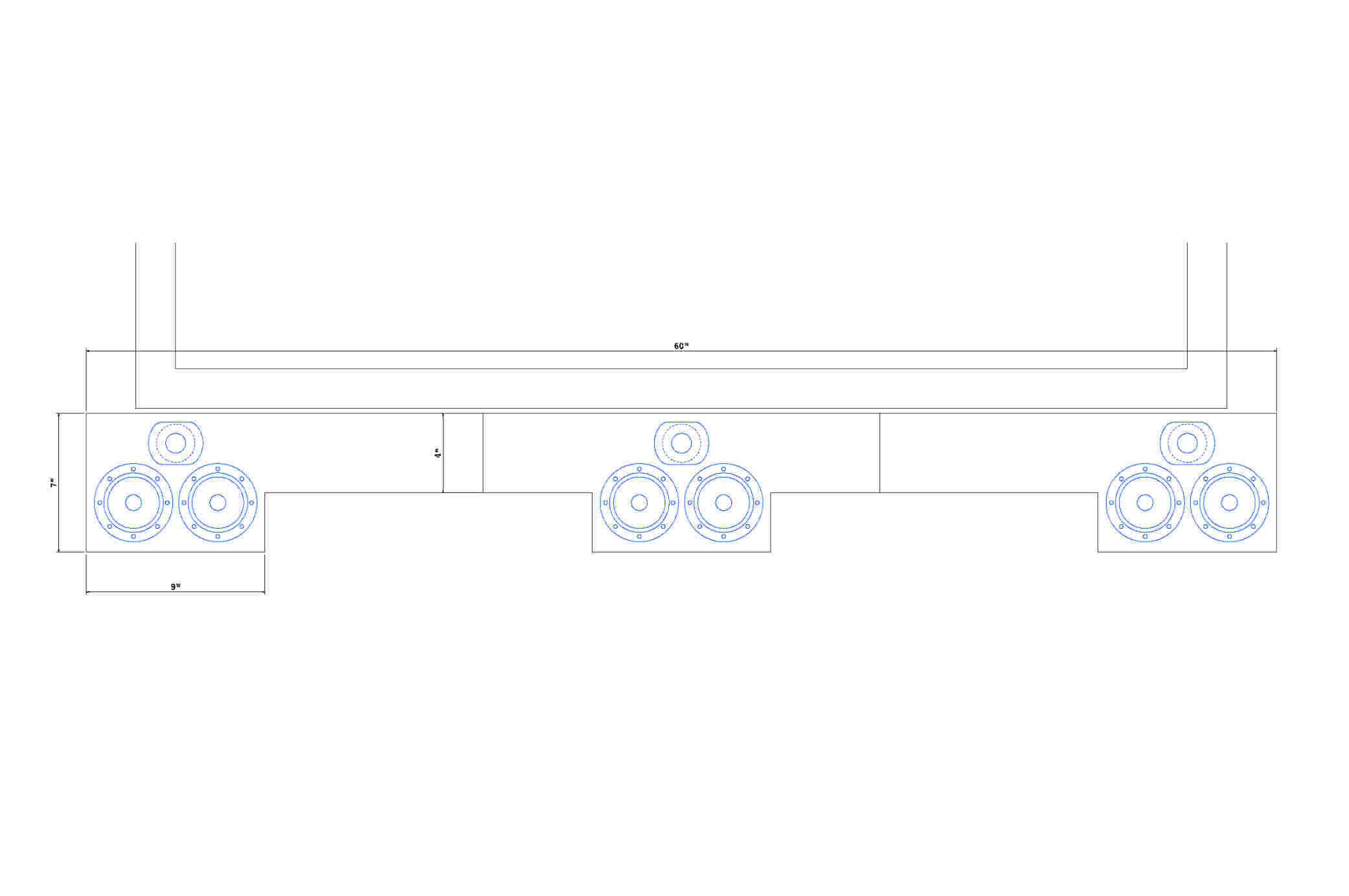

                How about something like this, with or without the center channel. Use pairs of 3-4" semi full range drivers, like the Dayton RS100, paired with a neo tweeter, like the Vifa D26nc55. Run them sealed and cross them over to a small sub at 120hz or so.
                Dan N.
