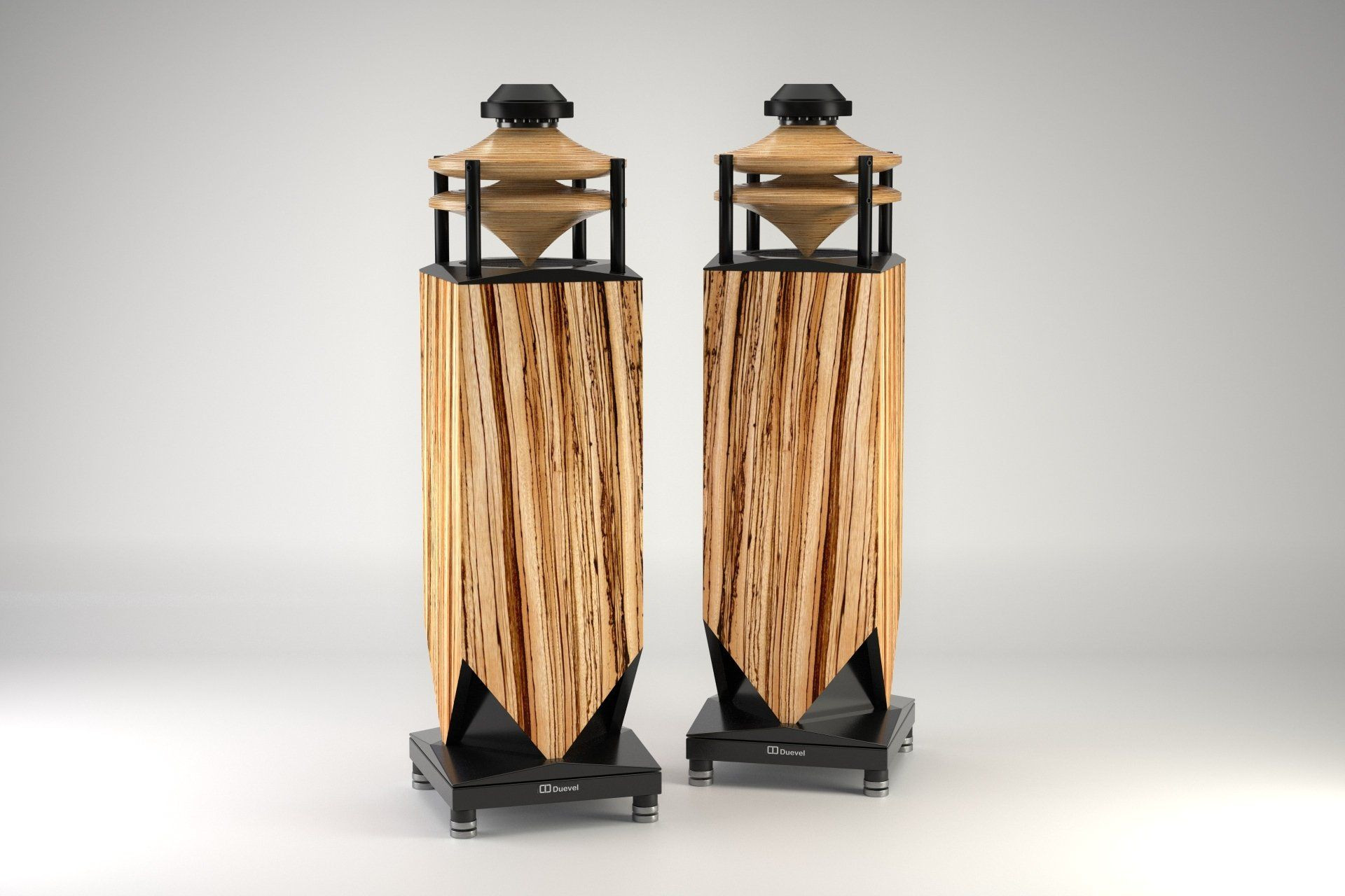

    I have been thinking of doing somewhat of a clone of a cross between their Bella Luna
    Bella Luna

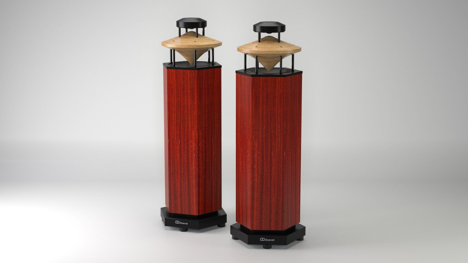

    and their Venus models
    Venus

    The Bella Luna seems to be very efficient for a two driver, 2-way system and a concern I had was how to make a reasonably efficient DIY version. I was hoping to use drivers that are fairly typical to the type of DIY projects we see on this forum regularly, ones that are well known and well measured. My thoughts were to use a body like the Bella Luna, but with a deflector/horn more like the Venus. I believe someone reasonably skilled with a lathe could turn these, once a design shape was determined.

    The tweeter doesn't need to be loaded behind the funnel or whatever you call it - as long as it doesn't have a phase shield, that is. You can simply mount it up top. Which opens up your tweeter options quite a bit.
    I wonder how dispersion will be with the 4-mid arrangement.
    I would probably lean toward the 3-way. This might be a great application for an Extremis on the bottom paired with a 150 (or 180mm) mid.
    The last omni I heard was very picky about room, or so I understood from some folks that had heard it previously and found the sound so improved they swore a change had been made (yet, no changes were made).

                One of the interesting things to me is that these are not like pointing drivers in all different directions to get some type of ambiance. Instead, they would seem to provide a very coherent 360º wave of music.
                CJD, my take on using the conical shape to disperse the tweeter is that it would take away the concern about off axis response dropping off. Whether on axis or 60º off axis, the sound quality and frequncy responce would be the same. I woudl think an up-firing tweeter, especially if it covers from 2000Hz or so on up would be somewhat dissapointing since you would be listening around 180º off axis. Does that make any sense to you?

                        I do notice that as you go up in price on the Duevel models, that they do more treatments to the edges of the baffle the drivers are mounted on. Also, on the Venus, the tweet looks to be mostely deflected, whereas on the Bella Luna and up, they use much larger voice coil compression drivers and definitely create a 360º horn/deflector. This would seem too complicated for DIY, so I was thinking more along the line of the Venus treatment and using a simple dome tweeter.
