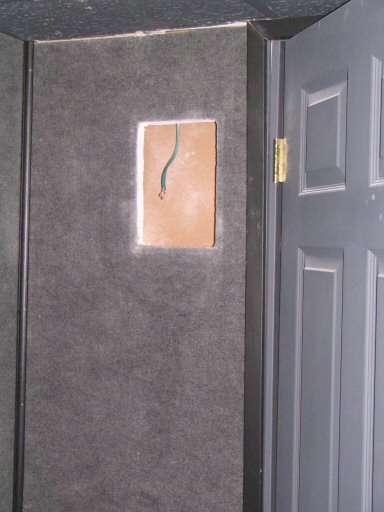

On friday I drove down to the Fed-Ex depot and picked up a sizeable box with a nice big Pinnacle logo on it and managed to avoid a few accidents on the very icy roads. That night we decided to stay home as the roads weren't suitable for traveling which meant that I had a free night to do some installing :B Here's a photo of the hole I cut in the back wall where one of the 4 K60's was going to be installed.
The K60's come in pairs and have a nice thick cardboard template that you simply tape to the wall and cut around with a dremel or a jig saw in my case. You need to make sure that there's no studs under where you intend to place the speaker and you should give some thought on how you're going to snake the speaker cable to them before cutting a hole in the wall. In my case with the false ceiling its very easy for me to pull cable to the install locations. I would also recomend using in-wall approved speaker cable. I got mine from Home Depot as its very reasonably priced and comes in a nice green protective sheath.

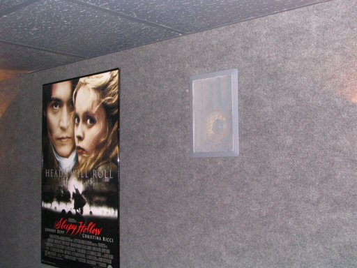

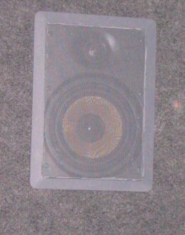

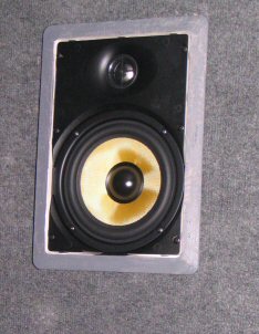

Here's two pictures of the K60's installed with and without the grills on. The grill off photo shows what they looked like after the first coat of paint on the plastic. I gave them a second coat with them pulled slightly out from the walls which worked for me but might be difficult depending for you if you are putting these into drywall which isn't as forgiving as my similar coloured carpet is.
