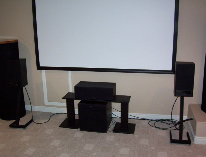

      here's a pic, I also use DIY bass-traps in the front corners and accoustic panels at the first reflection point, that's at least half the sound quality IMO.

                                                  My approach is a lot different, well placed speakers with room to breathe, accousitc panels and traps to correct room anamolies, and a full frequency signal to all 5 speakers, sub turned all the way down to 50Hz cut-off to avoid cancelations with the mains.
                                                  The overall sound is smooth, rich, and seamless. If I led you blindfolded into the room and sat you down you would not be able point accurately to any individual speakers location. In contrast to a typical set-up, where 5 point sources are blaring out into the room.
