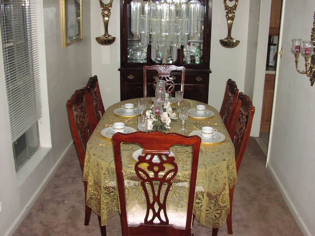

    I've been living in my house for 7 years and I have a formal dining room that is just wasted space......UNTIL I talked the wife into letting me turn it into a dedicated home theater, the only problem is, the room is small (16'2" x 7'6")
    But, just to get a feel of thing, I moved a sofa and recliner in to see what the space was like, and i think it could work. With the sofa against the back wall and 2 recliners in front of it against the side walls with a walk way in the middle for access to the sofa it was tight, but useable.
    But I have questions about viewing distances. I would put the sofa on a raised platform 5' deep and 6" high, and the recliners would be just in front of that so the 1st row viewing would be approx 10' while the second row would be 16. what would be a good projector for under $1K that would give me the best performance?
    I was trying to guess at what size screen I would use, because my room is only 90" wide with 8' ceiling. If i made a 74" x 42" screen that would give me 8" on both side to hang some custom drapes to help with the sound and look of the HT.
    Also I would have to mount the projector on the back wall above the sofa since space is limited and only the kids would be sitting back there, so their heads should not affect it.
    I have HDTV in the next room, so I will probably be watching HD, but mostly it will be used for DVD's.
    All suggestion and comments are more than welcome....
    I found a pic of the room...
