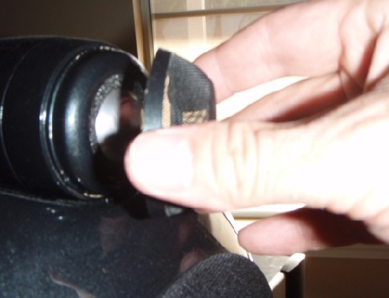

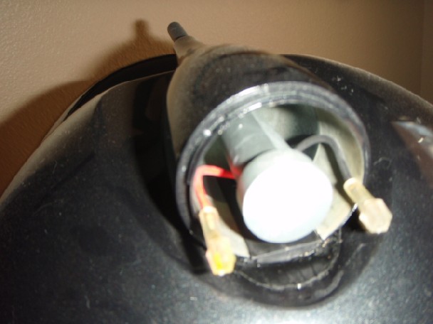

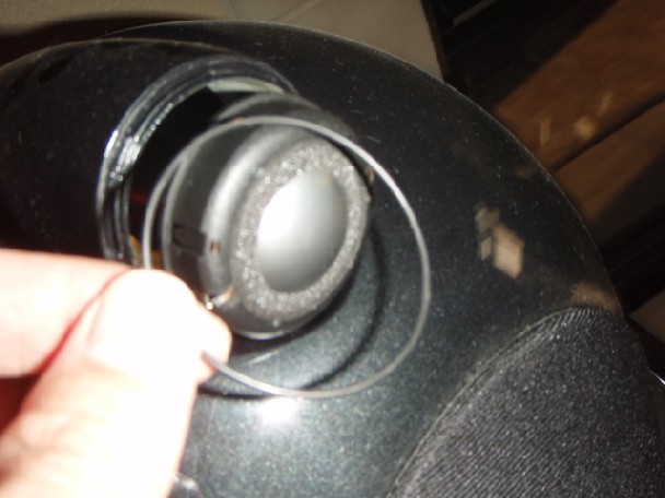

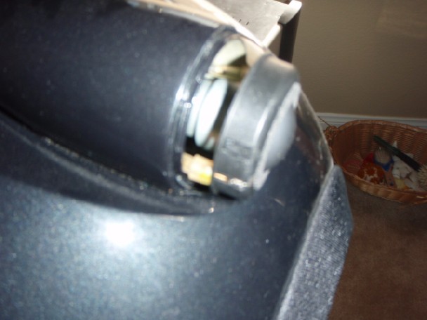

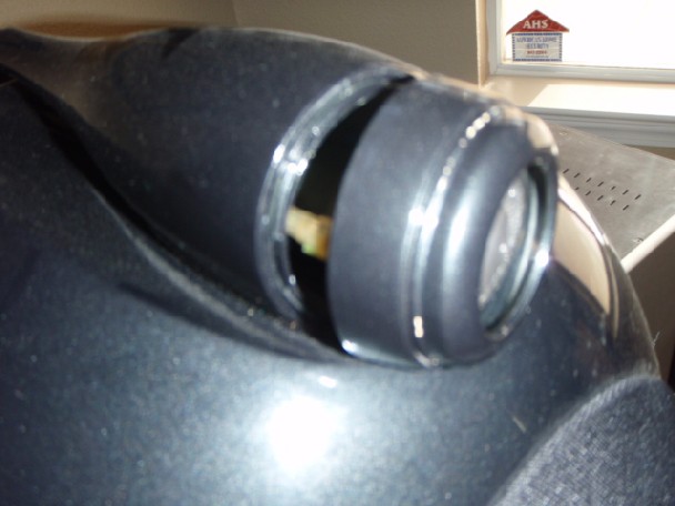

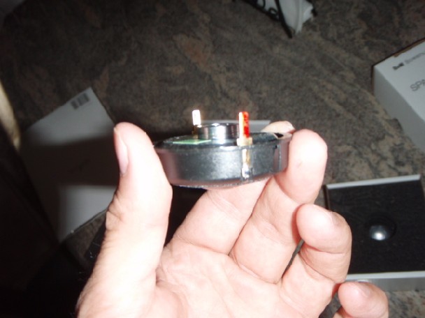

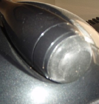

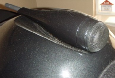

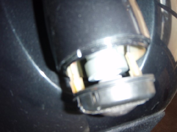

    The first 5 phots show:
    1) Bad Tweeter
    2) Remove grill (just pull off - held on by a magnet)
    3) Carefully grab the bezel and twist and pull out.
    4) 2 wires held on by push on tabs
    5) Just pull teh wires off, they are black and white.

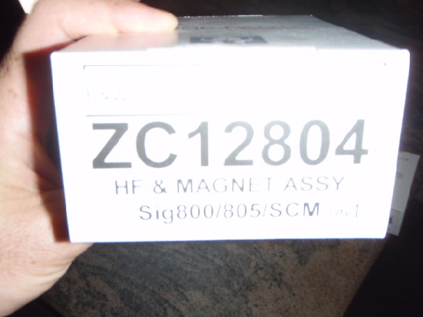

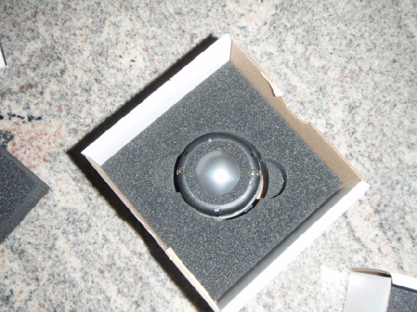

  • #2
    6) Make sure you have the right tweeter (B&W almost sent the wrong one).
    7) Nice packaging
    8 ) Positive marked with a red mark
    9) Plug the new one in, red to positive
    • #3
      10) Put the ribber o ring from your old tweeter on the new one. Put the bezel back on.
      11) Back in business.
