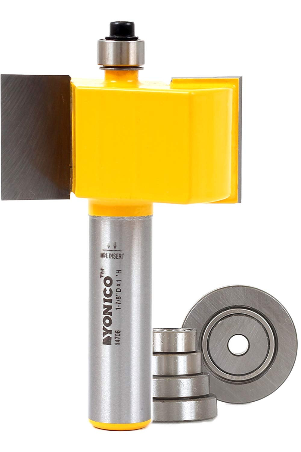

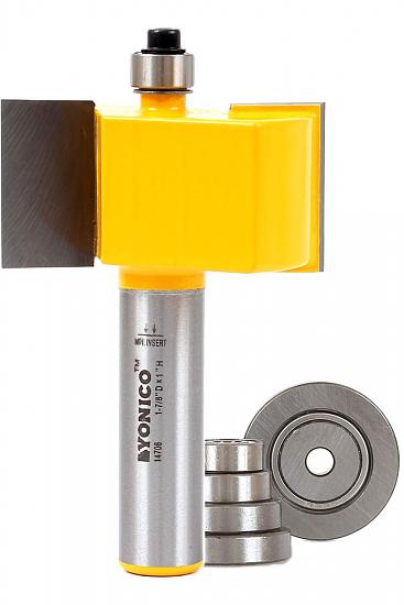

          I don't know how others trim out the rabbet on speakers, but I've generally gotten lucky in the past, that I didn't have to have any special router bits. I used the standard 3/8" or 1/2" rabbet and that always worked. Recently, however, I had a project, not a speaker, that I had to cut some rabbets, and I needed them to more precise than increments of an 1/8".
          I turned to Amazon, and picked up a set of these. These aren't the cheapest ones on there, and they're not the most expensive either, middle of the road. So far, I've been very happy with the quality of these bits, and for no more often than I have to use them, they will last me a long time, and if they don't, I just get another set, as they are not all that expensive. These work really nice for the rabbets, because if you start with a smaller rabbet, you can change the bearing to the next size up, until you get the fit that you're after:
          These are the Amazon links:

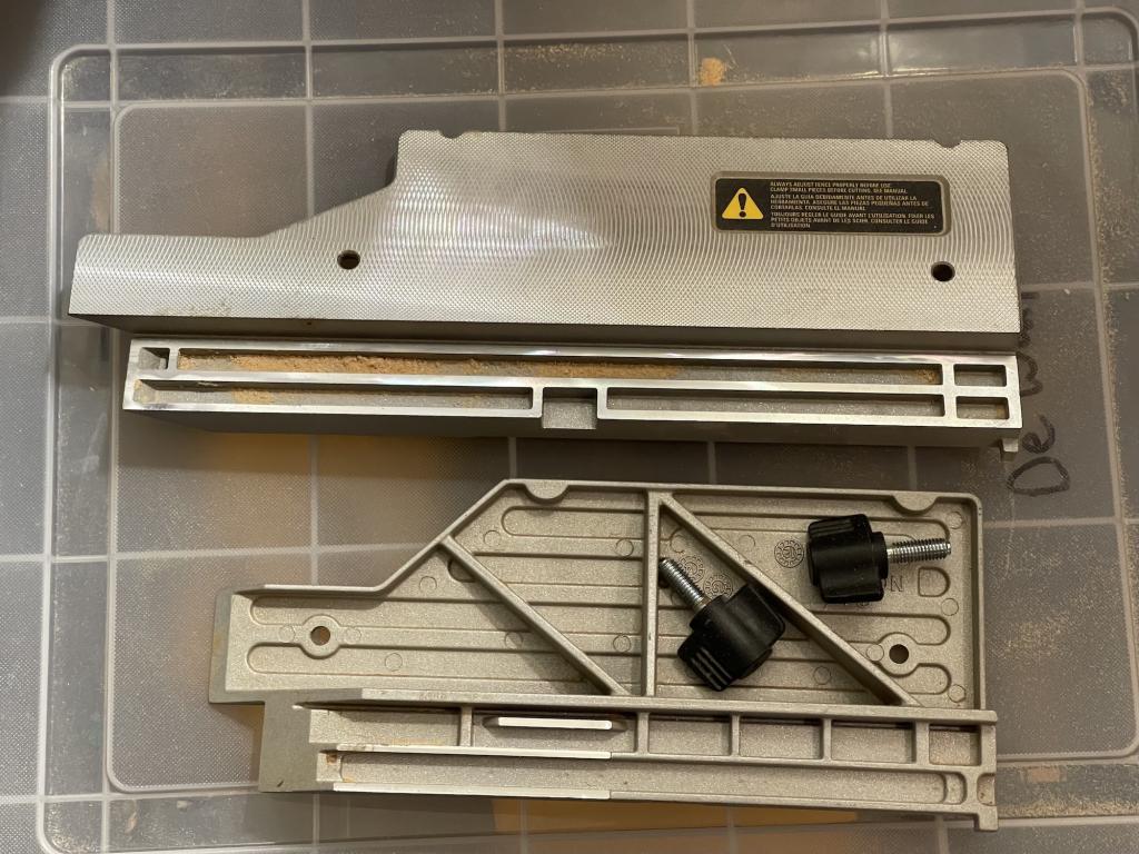

            • Next up, a review of how to setup the DeWalt DWS780 for 16" depth cuts- for those who might be considering making cabinets like the Isiris top module or Osiris Midrange/Tweeter module. I think this has been discussed before, perhaps just briefly, but for those curious about this, perhaps this would be useful- and I did this again for finishing the top section test cabinet, and this gave me a chance to do a documentation of the process, to inform anyone considering the same tasks.
              The DWS780 has two standard rear fence guides which have to be removed to extend the cutting depth. Twist on bolts with handles are provided for attaching these, and are quick and easy to remove.
Name:	Standard Cutting Fence Removed.jpg

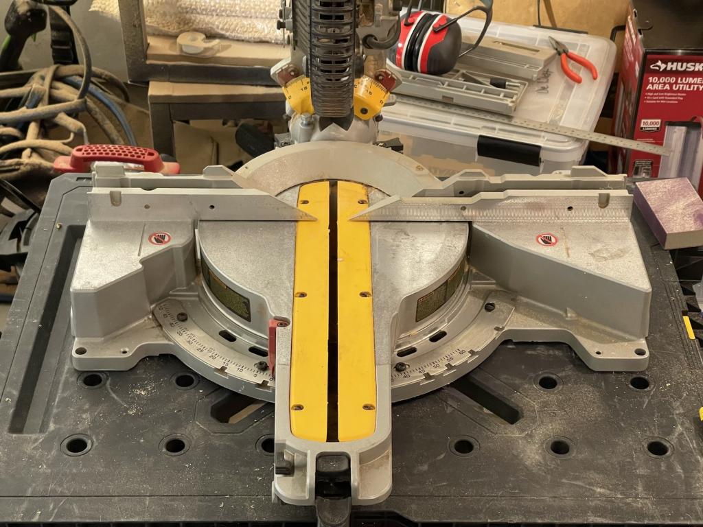

              This is what the DWS-780 looks like with these removed- note the slight tabs at the back of the slots where the normal fences slide in- those will be your working rear fence after fabricating and installing a new cutting board platform.
Name:	Ready for Platform Bd.jpg

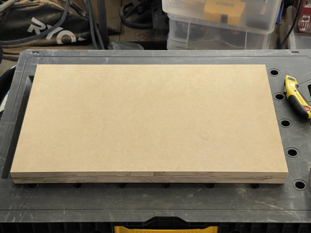

              The elevated cutting platform is fabricated from two 3/4" pieces of MDF that are 24" long and 15" wide. Why 15" deep? It needs to be deep enough to have material to hold it together at the front after making deep cuts, but shallow enough that you can operating the angle setting lock and be able to stick a flashlight under the board and read the angle setting from the scale.
              They must be glued together stacked up, to make a piece that is 1-1/2" thick. As an experiment, out of curiosity, I glued them together with Gorilla glue, and I must say that was "entertaining" but not something I'll likely repeat. However, the glue junction is quite strong- undoubtedly stronger than the MDF.
Name:	Platform Board.jpg

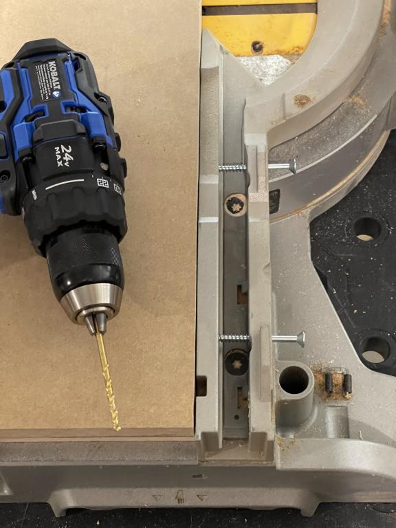

              I attached the cutting platform board with 3" #12 stainless screws- it's convenient to drill pilot holes with the board on the saw, then remove and drill out the holes to the necessary depth. I inserted and tightened slightly a screw at each position, leaving them in, to be sure they were all well aligned.
Name:	Pilot Hole Screws.jpg

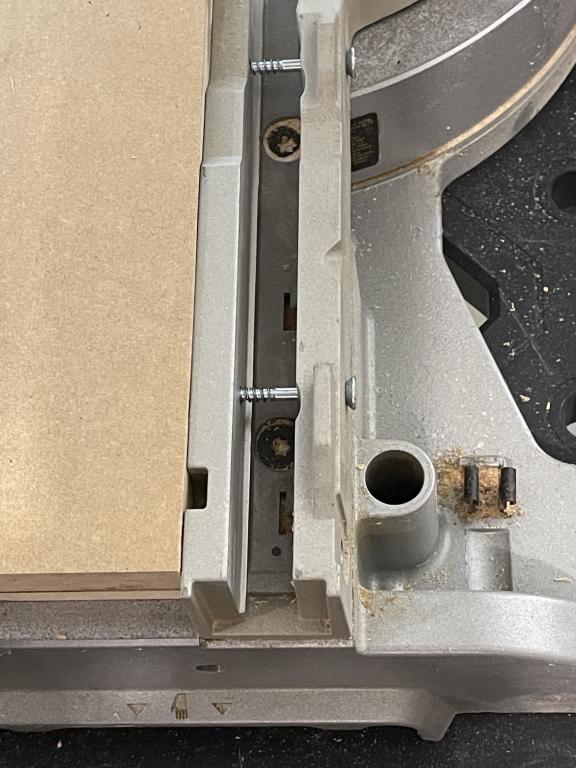

              • Then, all of the pilot holes have to be drilled out, and the cutting platform board can be attached with the 4 #12 screws.
Name:	PB Screwed down.jpg

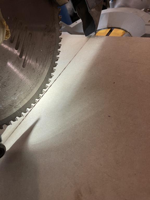

                One of the things I still like about this ten year old saw is the XPS, or Crosscut Positioning System- a fancy name for a light that illuminates the blade in such a way that it casts a shadow that shows exactly where it will cut when you bring it down to the working piece. Newer saws like my Bosch have a laser indicator, but this old fashioned approach works quite well.
Name:	XPS Guide.jpg

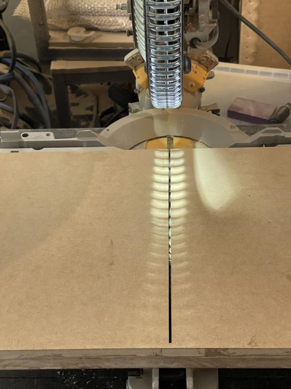

                The last thing to do to get this ready is to make an initial index guide cut in the platform board. I'm pretty much only going to be making 90 degree cuts relative to the vertical, so for now I just made one sample cut to show you. When making cuts at other angles relative to the fence (we're going to need 78 degrees and 73 degrees on this project) I recommend making similar cuts without the working material first.
