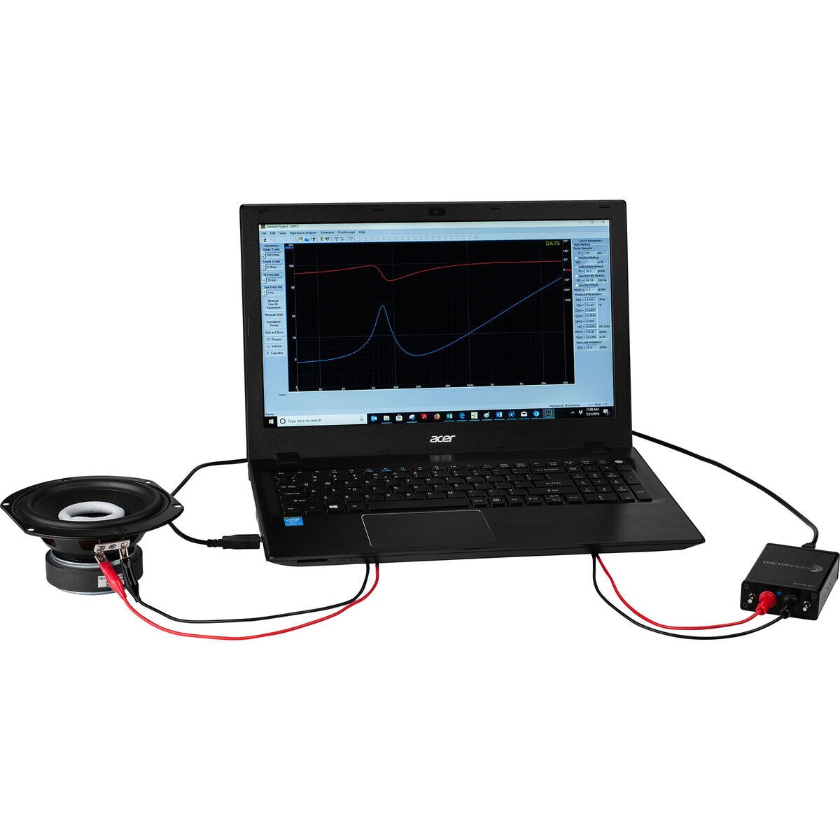

    Now, if you have a Dayton DATS setup from Parts Express for measuring loudspeaker impedance curves, you already have a basic LCR meter, but the inductance range isn't quite up to what I need fro crossover component testing- but for many, it will be adequate. DATS is under $120. But it takes a PC to have a working tool, whereas the B&K has a display and all the other stuff.

        I've got DATS v2 so an upgrade to V3 seems in order. I had expected the answer given what I was seeing, but I thought that I would check.

          Just use your DATS to measure the parts then...the DATS you have will do it just fine. No need to shell out another $200 to determine part values of salvaged parts.
          • #6
            I use a BK 878, very handy unit and a bit cheaper than the 879 suggested above. The 878 doesn't have the ESR feature of the 879, but the DATS will give that. I like the hand held LCR for working on equipment, the DATS is fine for crossover work.
