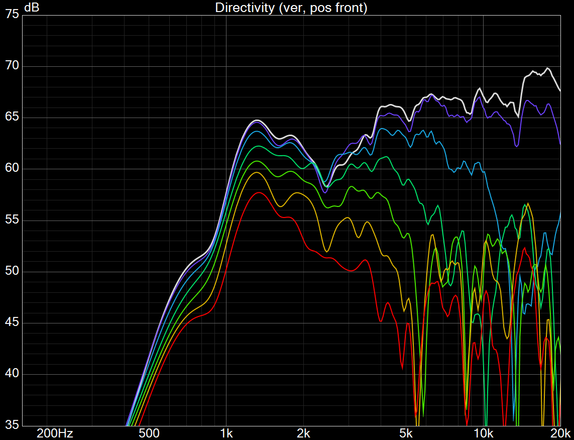

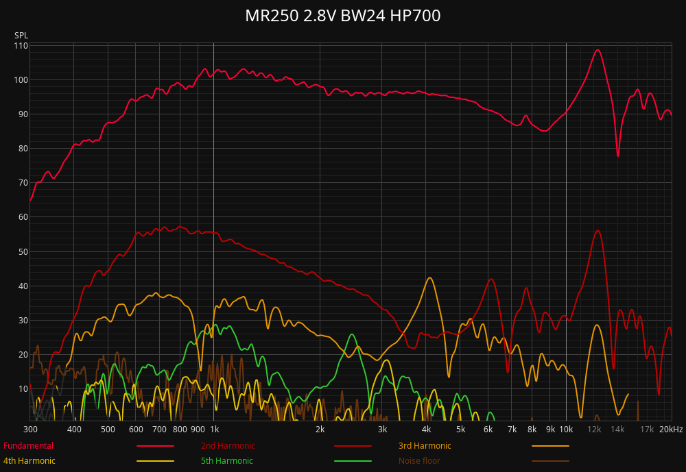

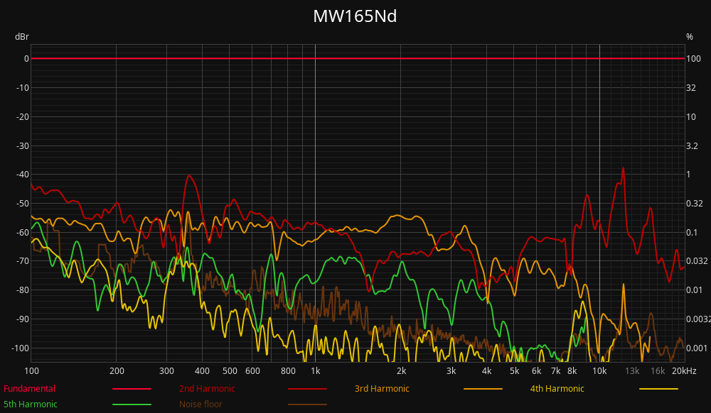

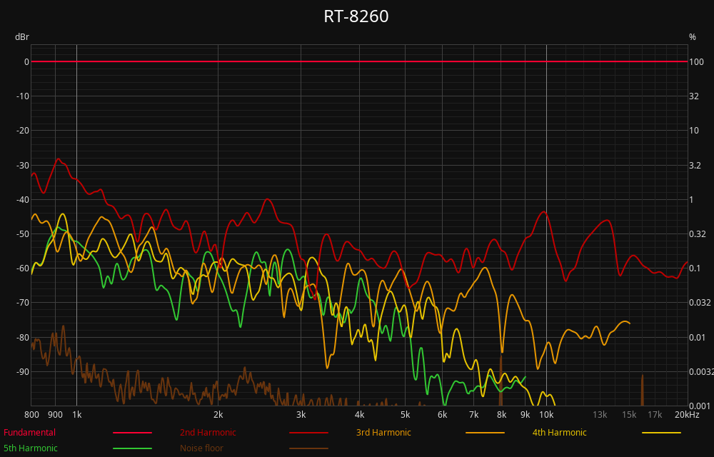

    Biggest problem with Omnimic is the noise floor is quite poor, with just a basic USB audio codec. OM1 mic has low self noise, and can be connected to low noise ADC. Here's some basic comparison I made some years back when I got it, and used Steinberg UR22mkii at the time, I am using Motu M4 now which is even better.
    Before I packed my Omnimic away again, I thought I'd take a quick comparison of distortion result between the Omnimic and my current setup consisting of a Line Audio OM1 and a Steinberg UR22mkii USB interface.
    I haven't bothered to do any more comparison than that. The OM1 mic has proven to be perfectly adequate. Omnimic only collects dust now, until I decide I need absolute SPL reading.

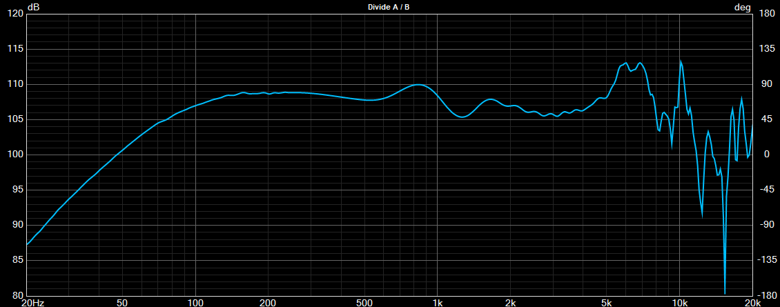

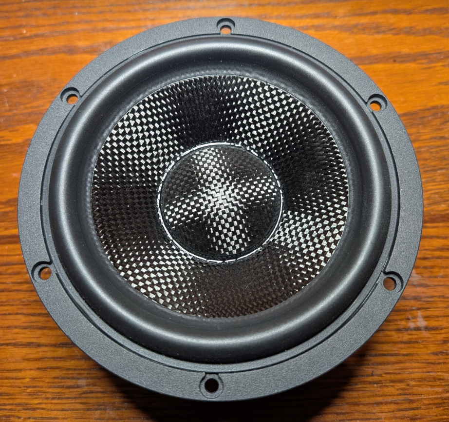

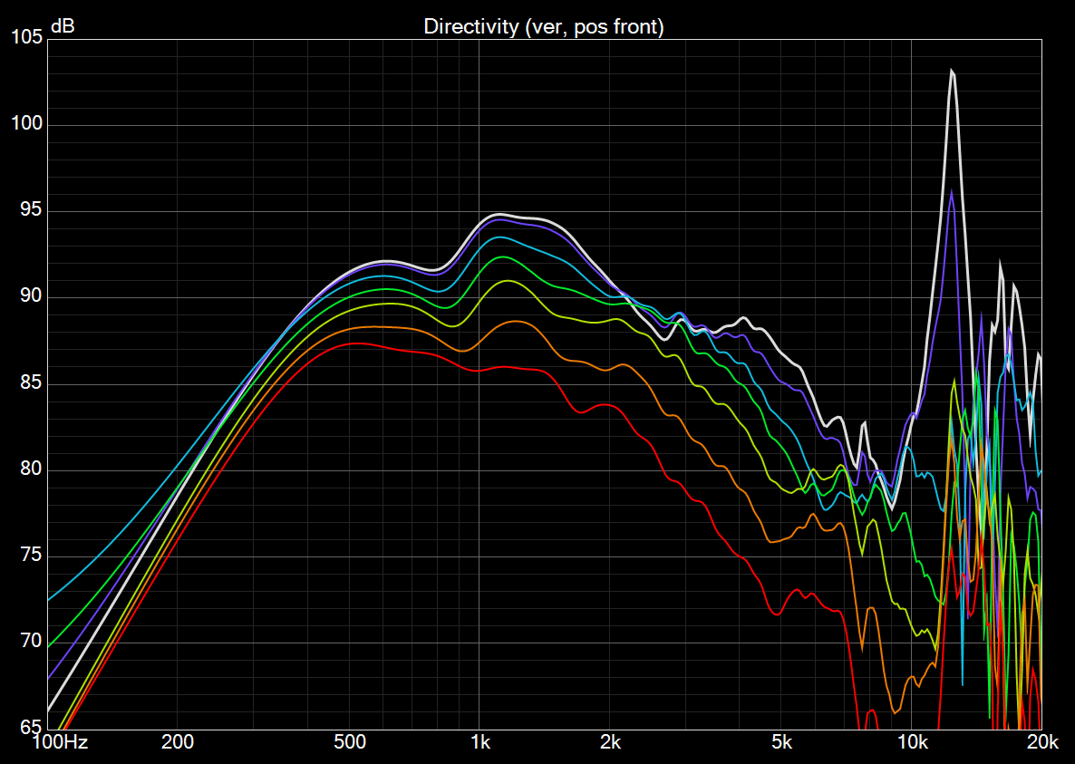

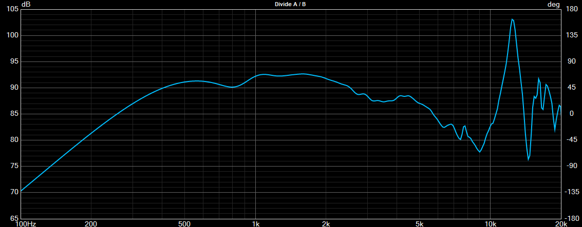

                    SB Satori MW16P-8.
                    Click image for larger version  Name:	image.png Views:	0 Size:	1.14 MB ID:	951431
                    Apart from a blip at 1.5kHz that is likely from the surround, the frequency response is very good. There is no damping goo on front or back side of this driver at the cone-surround edge, which I think could alleviate this problem. Unfortunate miss on this calibre of driver.
                    Click image for larger version  Name:	image.png Views:	0 Size:	135.1 KB ID:	951432
                    IB estimation.
                    Click image for larger version  Name:	image.png Views:	0 Size:	25.8 KB ID:	951433

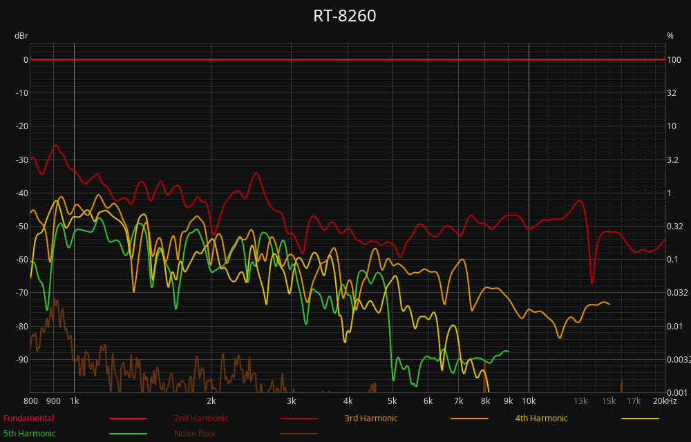

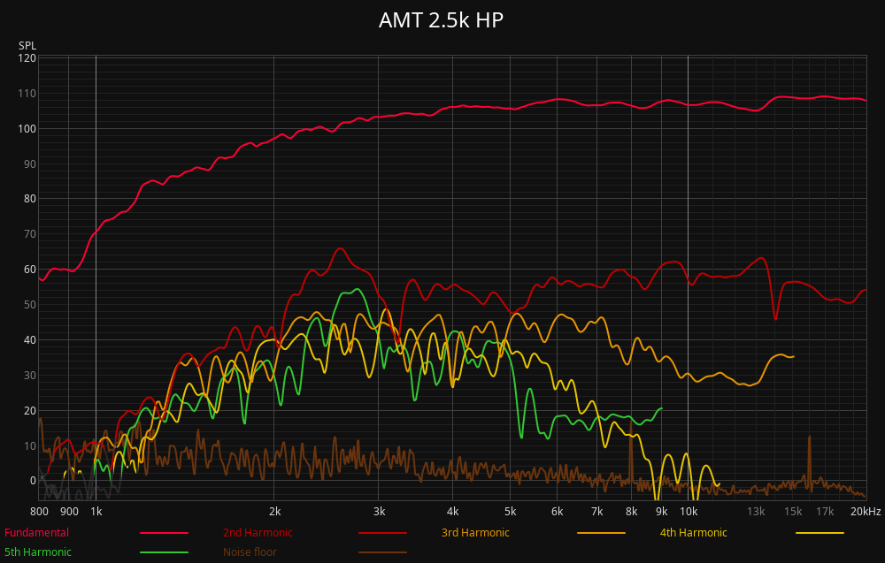

                    Distortion tested at 2.8V. Again, other than 1.5kHz blip, it's top tier.
                    ​​Click image for larger version
                    Again at +5dB (~5V).

                    • tktran
                      • 663
                      That higher order distortion really is outstanding!
                      That motor is fantastic; and I like the low weight of the driver too.
                      I wish SB would put an alu cone on the Satori motor. But I wonder if that would cannibalize sales from the Textreme Satori.

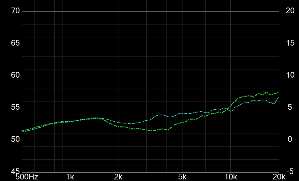

                            With a filter applied with 2.5kHz LR4 target.

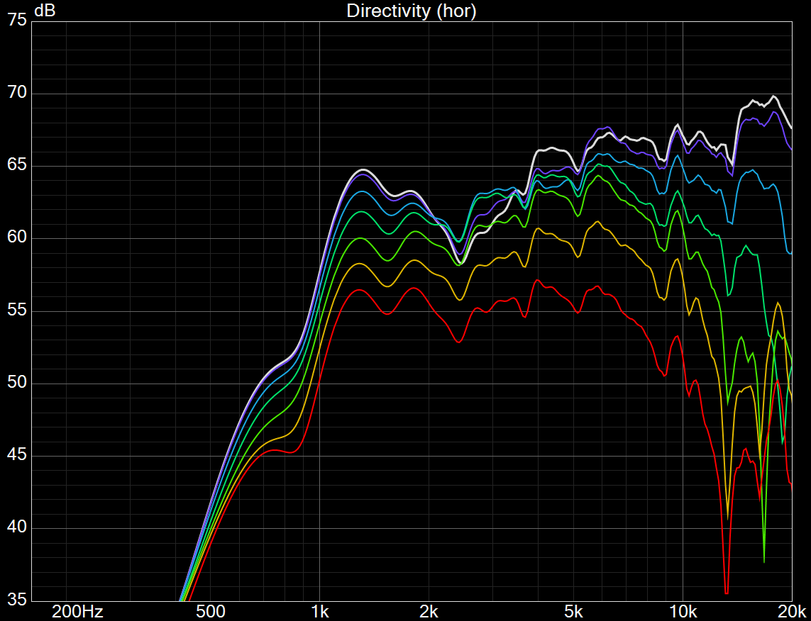

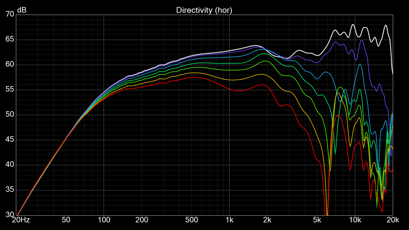

                                Directivity comparison. Here is power & di chart of normalized response for NE180W and 830883, very similarly sized drivers, but with different cone profiles, and of course one has a "phase plug". Dashed lines is NE180W, solid 830883.

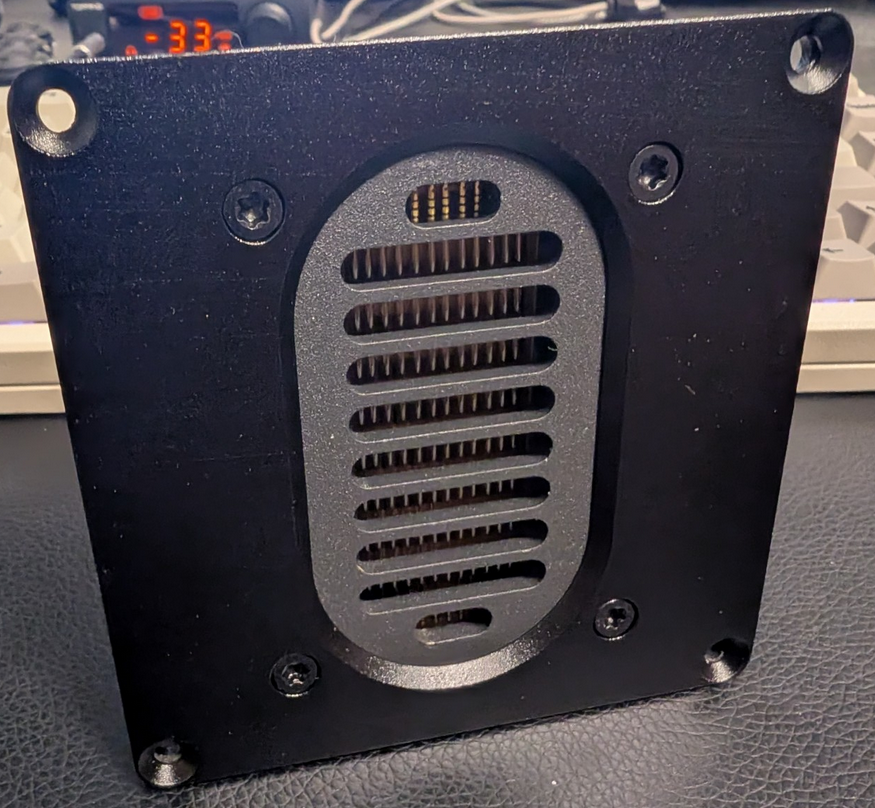

                                        Scan-Speak D2604/832002 "Limited Edition" tweeter. These are NLA, but as far as I can tell, the only difference from the standard D2604 is that they have a nice cast aluminum faceplate instead of plastic, and the voice coil former is titanium.
