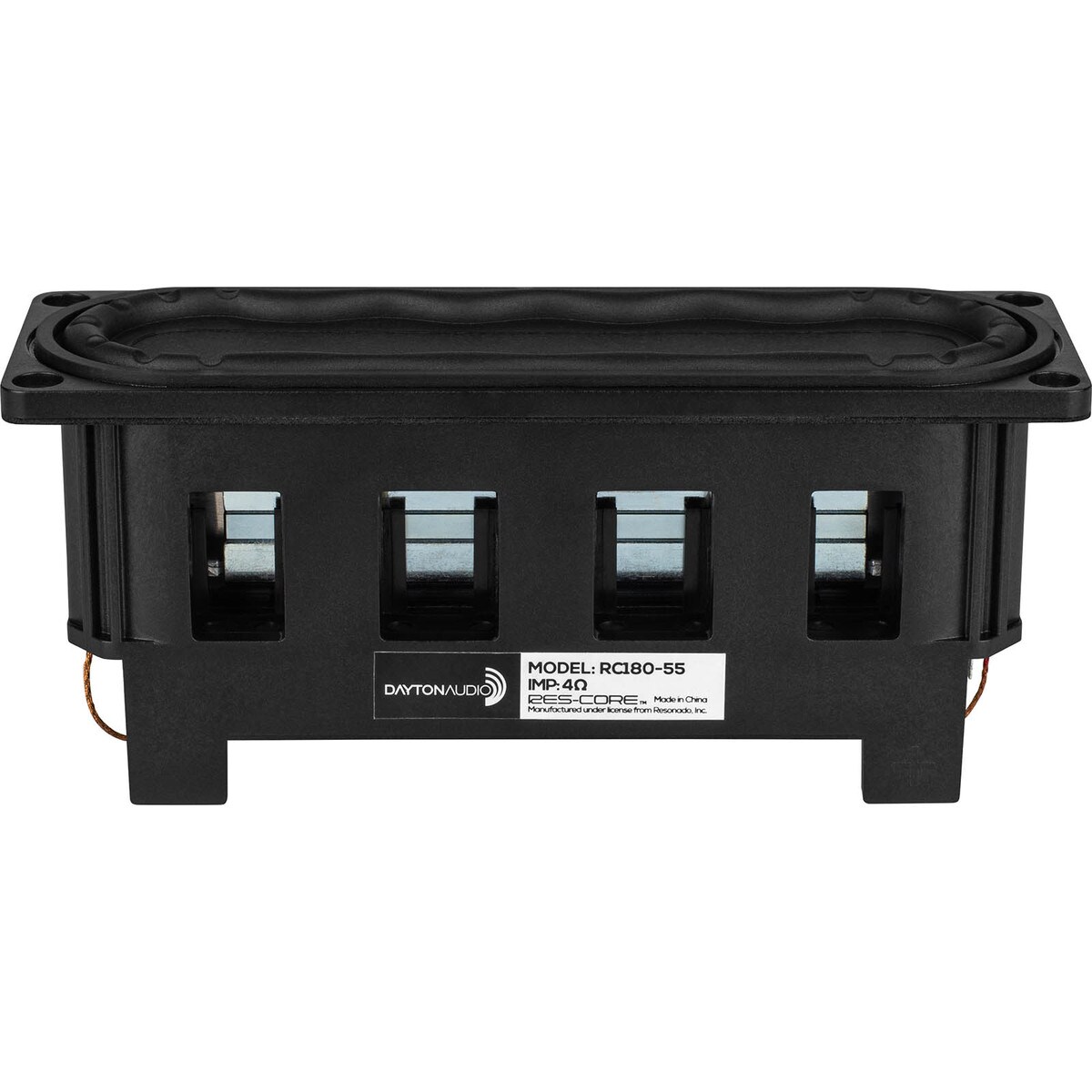

                                                                          • Check this thing out, I'd normally not post such a weird thing but the high-ish price caught my attention. Low sensitivity but good off-axis response when oriented vertically. However, that response has a heckuva downward tilt to it. Trying to come up with an idea for them...skinny desktop computer speakers maybe when paired with a small flange tweeter of some variety? Curious about the modeled bass response too - 30 Hz f3 in just 0.35 ft3? I suppose that corresponds with the sensitivity...
                                                                            Click image for larger version  Name:	RC180-55_h_and_v_frequency_response.jpg Views:	0 Size:	73.9 KB ID:	937593
                                                                            Dayton Audio RC180-55 2" x 7" Res-Core™ Neodymium Woofer 4 OhmDayton Audio RC180-55 2" x 7" Res-Core™ Neodymium Woofer 4OhmDayton Audio is proud to bring the RC180-55 2" x 7" Res-Core™ Neodymium Woofer to DIY speaker enthusiasts worldwide. This driver literally turns the voice coil on its side, allowing more excursion with smoother response than other high aspect ratio drivers currently available. You now have the opportunity to enhance your audio experience by creating an exceptional compact speaker system capable of lower distortion and deeper bass than ever before. Order your Dayton Audio RC180-55 Res-Core™ neodymium woofer today and unlock the full potential of your DIY audio projects!High-Performance, Compact DesignThis high-performance compact woofer boasts a unique 2" x 7" racetrack shape, making it the perfect fit for soundbars, portable designs, and other compact speaker projects. With a frequency range of 40-2000 Hz, 30W power handling, and nearly 1" peak-to-peak mechanical excursion capability (±12 mm Xmech), you'll be amazed by the powerful low-frequency capabilities of this high aspect ratio driver.What is Different About the RC180-55?Flat Voice CoilThe dual sided flat wound voice coil and aluminum bobbin create an extremely tall winding length and perfectly supports the high aspect ratio racetrack shaped diaphragm.Quad Gap Motor SystemThe quad gap motor design creates an extremely long magnetic field in order to exhibit consistent motor force even while being pushed to high excursion.Long Throw SuspensionAn optimized long throw surround and rear mounted spider maintain linear movement and consistent compliance during the extreme excursion required for high output low frequency response.Key Specs: Dimensions: 2-1/4" W x 6-15/16" LPower Handling (RMS): 35Power Handling (MAX): 70Impedance: 4ΩFrequency Response: 50 to 2,500HzSensitivity: 79.6 dB @ 2.83V/1mXmax @ 82% BL: ±4.7 mmXmech: ±12 mmDownload Full Spec SheetDownload FRD/ZMA Data FileThe Dayton Audio RC180-55 utilizes patented Res-Core™ technology, setting a new standard for racetrack shaped speaker performance. Res-Core™ architecture features an open-air motor with neodymium bar magnets and quad magnetic gaps, dual shorting rings, a flat voice coil on a flat bobbin, fully supported flat diaphragm, and a huge rear mounted spider. This unique design allows the RC180-55 to produce the low distortion and high excursion that is necessary to deliver rich, dynamic audio that you have to hear to believe.Fully Supported DiaphragmRes-Core™ architecture is ideally suited to narrow racetrack shaped drivers. With a conventional round voice coil, the edges of the diaphragm bend and flex causing unwanted breakup and increased distortion. The Res-Core™ flat aluminum bobbin extends the full length of the diaphragm to provide equal force across the whole radiating surface. This ensures that the diaphragm moves in a truly pistonic behavior for improved frequency response, higher displacement, and lower distortion.Powerful Quad Gap Neodymium MotorThe tall winding height and thin profile of the flat wound voice coil is an ideal opportunity to employ a multiple gap motor system. A pair of powerful neodymium magnets are sandwiched between steel plates, each with dual magnetic gaps, to create tall quad gap motor that allows consistent motor strength as the coil travels up and down. This novel approach makes it possible for the RC180-55 to maintain nearly flat Bl all the way up to ±4.7 mm of excursion. Thanks to consistent motor force, this driver will produce minimal amplitude and intermodulation distortion even when pushed to incredible levels of displacement. Also, the voice coil and motor are completely open for the efficient heat dissipation that is required for high power handling with low power compression.Long Throw SuspensionIn order to keep all this potential excursion under control while maintaining liner voice coil travel, the RC180-55 has a long throw suspension unlike any other. The surround has been optimized to keep any surface area modulation to an insignificant level, even when driven to high excursion. Actually wider than the cone and running entire the length of the aluminum bobbin, the huge spider is mounted behind the voice coil for maximum linearity. With ample space and deep convolutions, the spider maintains its level of compliance while allowing a peak-to-peak mechanical travel of almost 1" (±12 mm Xmech). This one-of-a-kind arrangement further reduces amplitude distortions to guarantee incredible dynamics and remarkable output capability.Excellent Off-Axis Frequency ResponseWith predictable on and off-axis frequency response, the RC180-55 is the perfect driver for any designs requiring wide dispersion, such as sound bars, portable Bluetooth systems, and powered smart speakers. In the vertical orientation the overall response remains consistent even at 45° off-axis. We've Got Your BackWe stand behind our products and our warranty is a demonstration of our commitment to quality and reliability.Learn More SpecificationsQ&AReviewsManuals & Resources
                                                                            • Given my general reputation, I trust that no one will be troubled if I should make some pointed and acerbic comments regarding this "device"...
                                                                              After a cursory and then more detailed review of the data sheet, my initial thought is that some engineer had what he believed was a clever idea and was able to get a relatively inexperienced marketing person to sign off on a development project.
                                                                              Alternatively, I might merely opine that it appears to be a solution in search of a problem of unknown characteristics....
                                                                              As an aging Sith, I believe that no one should hold a few pointed observations against me, and if they do, it will not trouble me....
                                                                              • The size, at 2" by 7", is not suited it would seem for some possible compact applications where relatively low SPL capabilities might be acceptable...
                                                                              • With a half plane sensitivity just under 80 dB, the 4pi sensitivity will be about 74 dB with 2.83VRMS. Due to the low impedance, (about 3 ohms) this translates to an input power over two watts. Let us be charitable and say just 2 watts. With an RMS power capability of 35 watts, this is 12 dB greater than the 2.83VRMS rating, which would make the 4pi space SPL capability about 86 dB. Certainly not deafening- those wishing to avoid excessive SPL will find this to be most satisfactory....
                                                                              • The Xmax is 4.7mm; this and the Sd of 56 cm2 put it in the category of typical 4-1/2" mid woofers. The Qts is quite high, at 0.89, meaning that only a sealed alignment is reasonable, and that will not be close to critically damped. These are all factors of the T/S parameters that result in such low sensitivity but relatively extended response, albeit at very low SPL. Consider that with this cone surface area, the cone excursion for lower frequencies increases rapidly- Unibox will tell the story. Perhaps if one used 9 of them together, like a Bose 901...
                                                                              • However, a conventional 4-1/2" mid woofer, such as the Wavecor WF118WA07 has a half plane sensitivity 6 dB higher, flatter more extended frequency response, and a flatter impedance curve, indicating the possibility of lower inductivity modulation and lower midrange distortion. However, it is round, not just 2" wide. But it is not seven inches long, either. And it would require porting or a PR to extend the LF output without EQ. But with EQ, it would be able to play just as loud as the RC180-55.
                                                                              • The Wavecor is $25.67, while the RC180-55 is $54.
