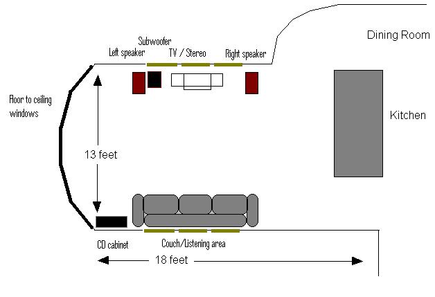

      David,
      Thanks for the information. I have attached a diagram of my living room and where I intend to put the accoustic panels. They are that strange brown/gold color items directly behind the speakers and couch. Can you give me any feedback on the placement I am intending because I'll semi-permanently mount them there. Do you think I should get a bass trap? The speaker on the left is noticably louder on the bass (not just because of the subwoofer) even though I've bumped up the balance on the right speaker a notch or two.
      Thanks very much,
      Karim

        Karim, your room isn't exactly perfect as far as symmetry, I'd doubt you'll hear much improvement with the Auralex added in there. How about a suggestions, but it might not sit well with WAF. How bout trying turing your mains to where the floor to ceiling windows are and then sit opposite to that? It'll make it so you're not sitting too close to any of the room boudaries and then you can get the type of acoustic panels on a stand that David Meek suggested. RealTraps makes theirs on a stand...heard good things about them as well. Good luck.

          I thought about having the speakers facing the long side (speakers near windows and facing the kitchen) but that would pretty much make me lose all natural light and window view.
          It sounds like I have two seperate problems:
          1.) Tight area causes slap flutter/reverb and poor audio definition.
          2.) Off balance room (windows on one side reflect sound too much but open area on the other side of the room doesn't reflect at all).
          Is that an accurate assessment of my problems?
          For #1, the accoustic foam should help by absorbing the sound bouncing off walls and in essence making my room sound less confined.
          For #2, can a bass trap help with the balance issue? What if I put a bass trap near the windows plus some curtains to absorb the window bounce and then offset the balance of the stereo so the right speaker is slightly boosted to compensate for the lack of wall on the other side.
          I am looking for a balance between audiophile accoustics and nice looking living room environment which is why I like the Auralex B24 (they will look nice on the wall).
          David also mentions I should put a sound absorbtion panel behind the speakers but not much value in having one in the middle between the two speakers). Should I instead have 4 panels opposite the speakers and two behind the speakers?

                      I just noticed your pix for your room. I would agree that you are not going to get much help from the treatments. I think Blaze said that. The most that you could do is put some strips in between the windows if there is the space. ( use the foam that you can cut.) And something on the back wall behind the sofa. Definaly use the spacers if you can to suck up some of that bass banging back off the back wall.
                      But that is all I THINK you can do. But then again, I am by NO MEANS the acustical expert on the matter.
                      PS: sound is going to have a field day with the glass!
